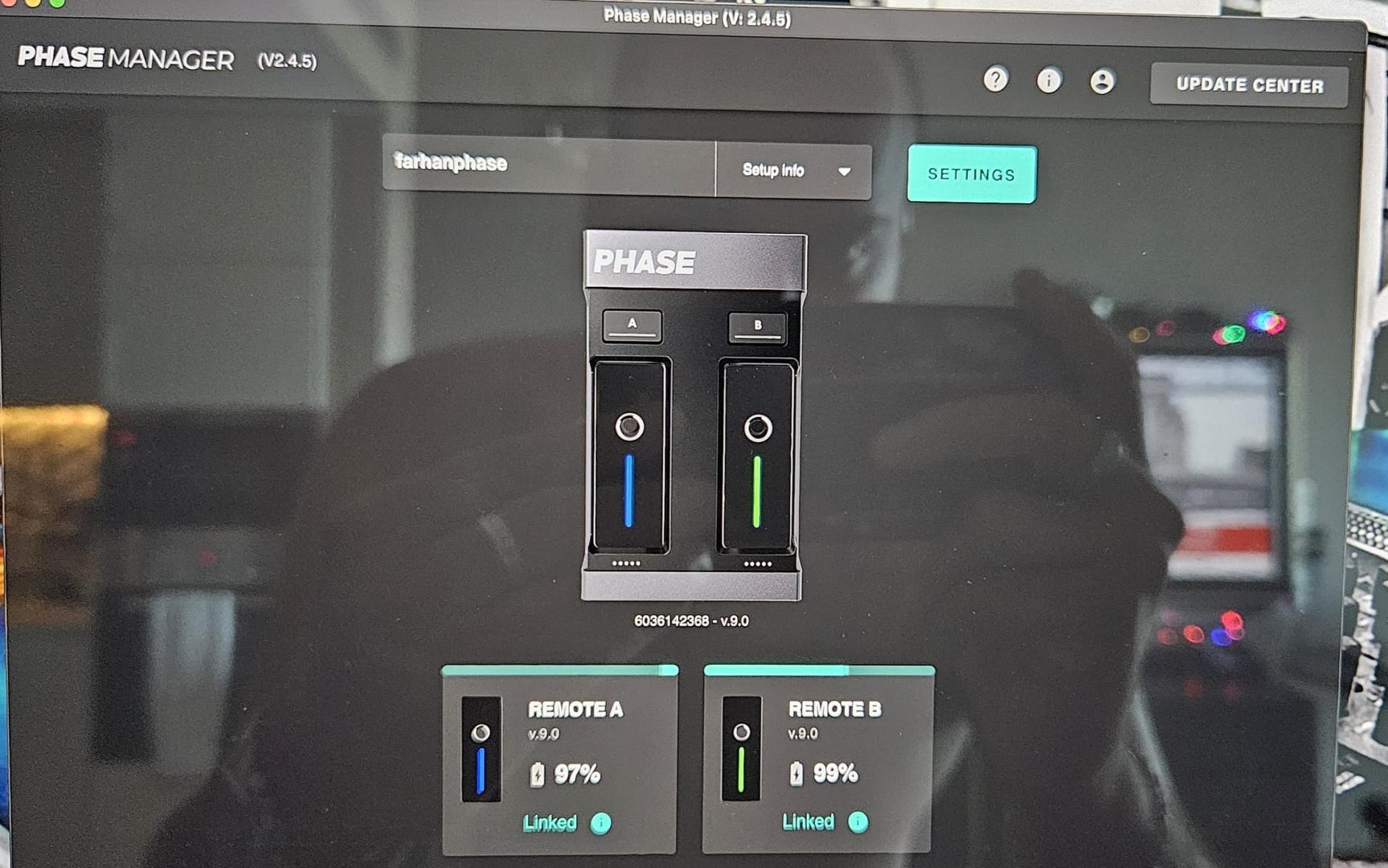

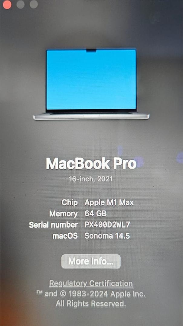

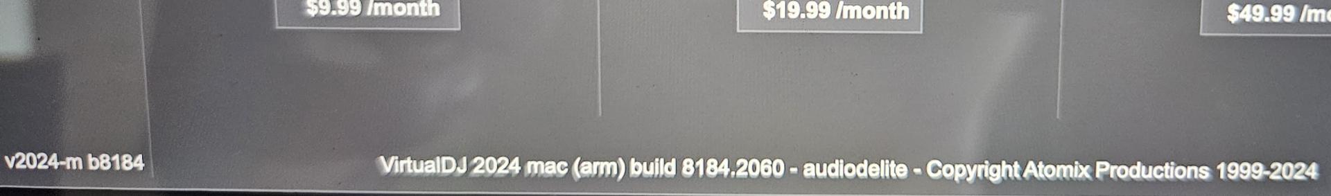

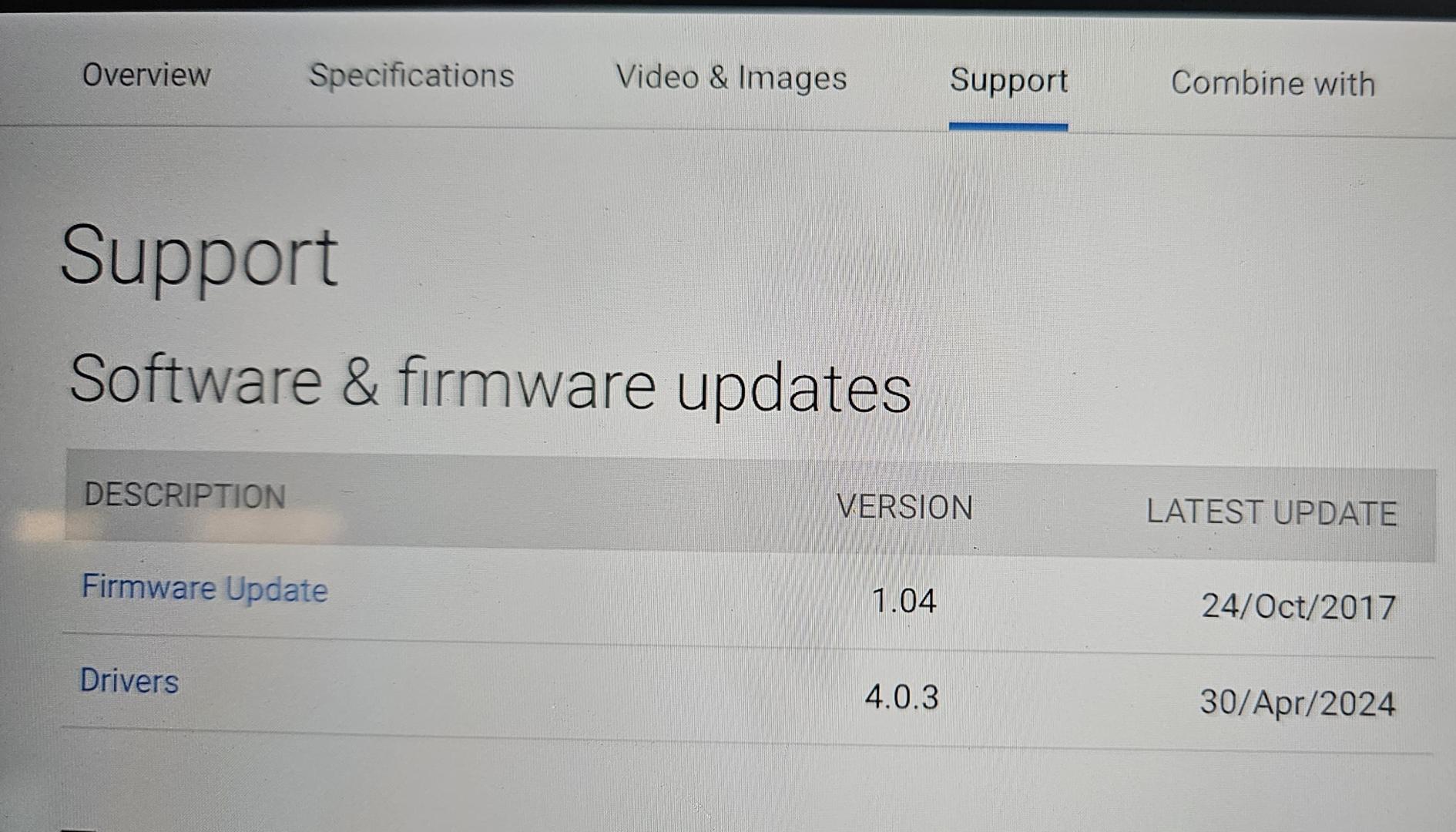

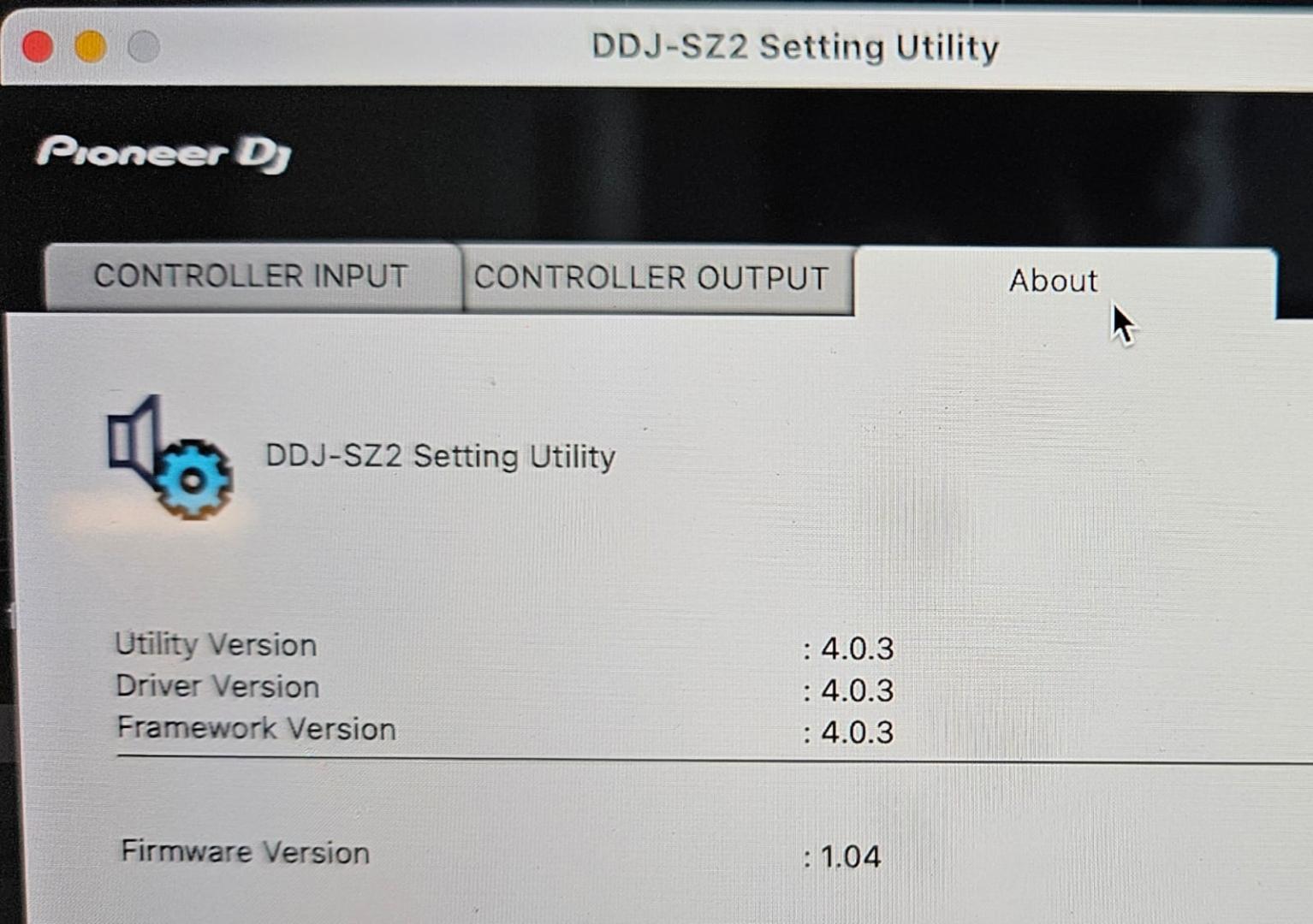

Hello,
Attached the following:
vdj version.
phase version.
ddj sz2 sw and fw version.
mbp version.
pioneer driver page confirming i have the latest and greatest version installed: Download firmware or software for DDJ-SZ2 - Pioneer DJ - Global
Please let me know if there is anything else you need from my side.
Posted Mon 10 Jun 24 @ 1:18 pm

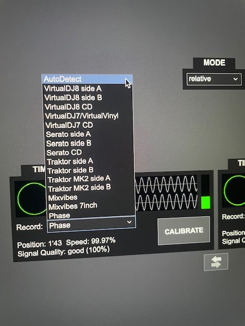

in Timecode settings in Virtual DJ choose "Record"= Phase, then in Phase Manager Setup switch to Recordbox Timecode, and calibrate remotes, and back in VDJ calibrate DVS Phase, done.
I remember earlier versions of VDJ, in 2014-2018, I used Serato Records, and Traktor Records, but last 2/3 years I also noticed Traktor Records have issues in VDJ (cant find my Serato timecode records) but I sometimes use my technics SL-DZ with serato and Traktor Timecode CDs and they work fine in Virtual DJ.
