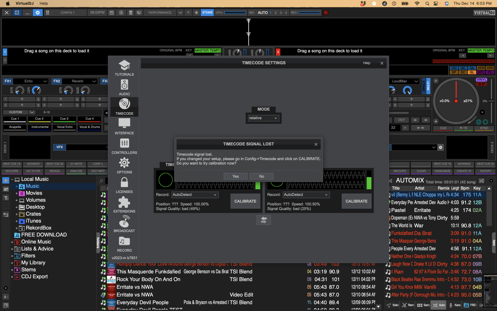

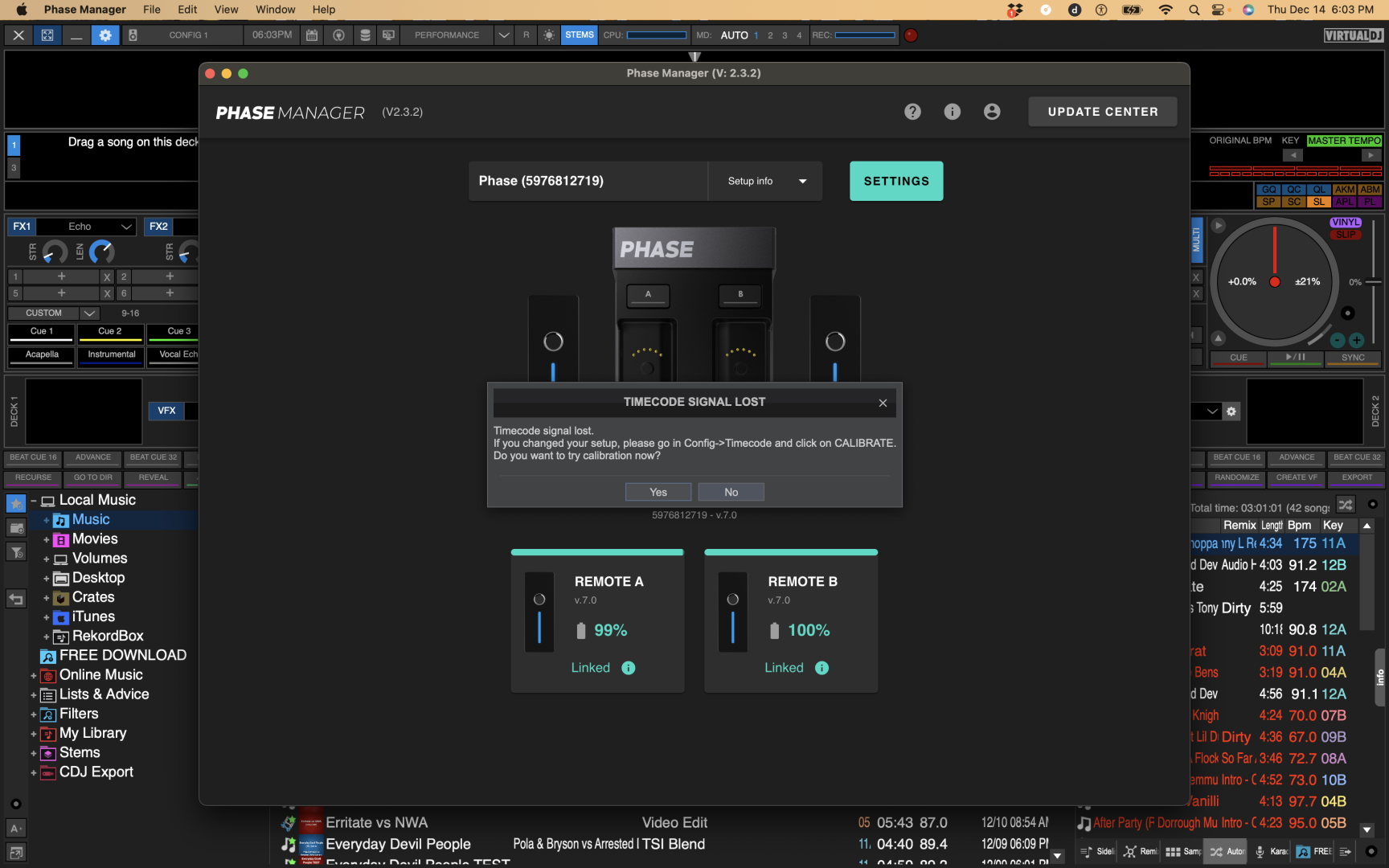

Ok so I guess 2.4 is gone but I can get SDJ and Rekordbox to work with DVS mode but this is all I get with VDJ
What am I missing here??

From b7831, you may have to ignore Phase in the list of controllers since by default, VirtualDJ now expects to use it in HID mode (see the manual).
Other than that, the phase signal should be autodetected, and given you've set it up to transmit Serato or VirtualDJ timecode and you mixer is set to Line-In, it should work.

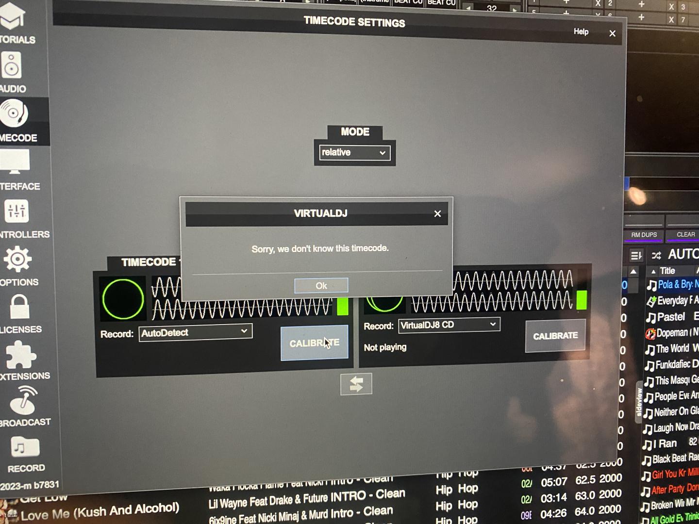

I swear Im about to sell this crap and just stick to needles or my RANE 12s
Now this is all Im getting no matter if I use the VDJ or Serato timecode.
Like I said everything works with SDJ or Rekordbox so I know its VDJ not working and its probably something dumb......
Posted Fri 15 Dec 23 @ 12:06 am
So it seems that with the new version (b7831), the Phase timecode selection isn't automatically detected anymore. Given you've set everything up correctly and ignored Phase as a controller in the Controllers tab, you have to manually set it to Phase as the timecode option from the list:
Posted Fri 15 Dec 23 @ 1:12 am
You sir have saved Phase from my smashing it to pieces 😝 I knew it was something dumb!!
After MANUALLY setting it Phase everything is spot on again. No to test switching between dis which is where it always gives me problems but that's for another thread.
Posted Fri 15 Dec 23 @ 3:10 am
Glad to hear it was resolved. @Devs Maybe VirtualDJ should always set the timecode type to Phase given Phase is connected, like it did before b7831? I guess there's still the question of which one to choose to obey (HID or DVS) in the case both are setup correctly and the RCAs are connected?
