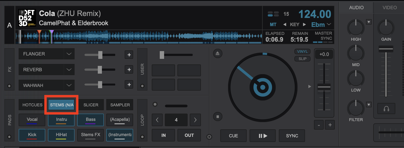

I'm using a MacBook Pro with M1 chip, and it used to work a few weeks back. I have Hercules DJControl Inpulse500 mixer. Whether I connect the mixer to my laptop or not, when I try to use stems, nothing happens, and it shows as N/A. Any idea what might be the root cause/ how to fix it?

Most likely cause is your track is streamed from Tidal
(assuming you have not turned off the stems engine)
Tidal NO longer allows Stems separations of streamed tracks.. for the last few weeks.
Thread for Ref:
https://www.virtualdj.com/forums/254722/VirtualDJ_Technical_Support/TIDAL_STEMS_ARE_OUT_.html?page=1
Thread for Ref:
