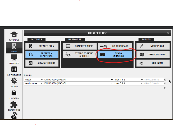

I have tracks loaded on decks 1 & 2..when i press play on the controller, deck 1, it plays on channel 2 on the Denon, which is where i want it to play.......BUT when i press play on the controller, deck 2, it doesnt play on channel 3 like it use to, it now also plays thru channel 2.....
I dont understand......any help would be appreciated...i'm sure there might be some additional info that you all might need...please ask away...thanks..jimmy

Read this .. https://www.virtualdj.com/manuals/hardware/denon/mc6000/advancedsetup.html
, choose the mixing type Software/Hardware and apply the correct Audio setup.

Hi..for some reason, i cant get the "DN-MC6000" block to highlight..
