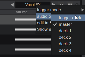

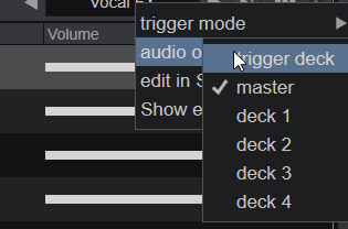

By default, the sampler output is set to Master
With this setting, regardless of which deck triggers the Sample, it is sent directly to Master.
I want to be able to trigger a Sample from a particular deck, and I want to send the output to THAT deck only so that I could control it with the volume slider for instance.
And I don't want to hardcode this to "deck 1" or "deck 2" etc.. I want this to be dynamic - trigger deck.
I try to add "Trigger Deck" option
Then I try to disable "Master" by clicking on that option to disable it.
But that doesn't work - when I click "Master" to toggle it off, "Trigger Deck" gets disabled and we're back to just "Master" setting. Sounds like a bug to me..
Would anyone know how to set "Trigger Deck" on Sampler output by default via a configuration setting?

Trigger deck is not meant to be the opposite of master master. It's an extra option for when external mixer configuration is used
From the manual:
"By default the Sampler is routed to the Master & Headphones Outputs (or all decks if an External mixer audio setup is chosen). A different output can be chosen from the Sampler Options menu. You can choose to route the Sampler Output only to the Headphones channel or any specific deck.
If an External Mixer Audio Setup is selected, you could either select a specific deck as Sampler Output or choose the trigger deck option. If trigger deck is selected then it will route the Sample only to the deck where the sample was triggered from (either using deck specific shortcuts, or from a GUI or even a MIDI controller)
The ‘Headphones only’ option will not be available if no Headphones are available in the Audio setup."
On the other hand, if you select a specific deck in the drop down, the master selection will disappear

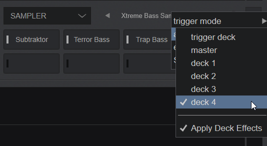

This is so strange - I'm really confused with this Sampler Output configuration when using Controller pads.
When I select "Deck 4" as Sampler output
it is essentially the same as "Trigger Deck" to me even though "Trigger Deck" is not selected:
- the sampler output is sent to the channel/deck who's pad triggered the sample, and
- even though i selected "Deck 4" ANY deck can trigger and receive the sample output
To me, it would be much more straight forward to enable "Trigger Deck" as an option for this.

As I understand it, it (should) simply mean that no matter how/from where you trigger the samples, the audio is send through the selected channel - so in your case channel 4 - so that volume and maybe EQ and so on can be controlled by the knobs and sliders on that (unused) channel
