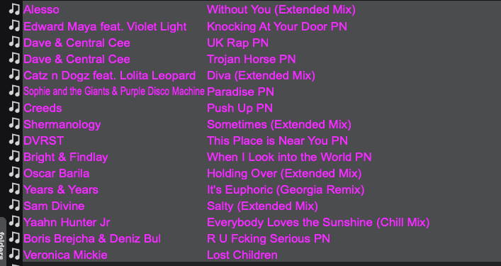

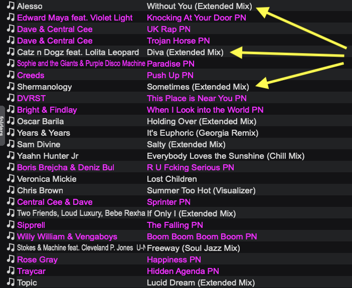

After a few weeks, I decided to change the color of the Platinum Notes processed files so it would be easy to see them using the quick Color Filters. I then noticed that not all processed files were changing color, very puzzling. Those that are not changing color also do not have the letters _PN at the end of the Title even though they are part of the filename and should be copied into the Artist & Title fields.
After investigating today I have found out why it is happening. The files not changing color have a common denominator, it's because of the use of brackets () i.e. (extended) (remix version) etc. see pic below. I tried square brackets too with the same result. []

needs "contains"... logic.. to work.
for some reason, the filter logic is seeing the "end" as mp3
(since, guess mp3 is the end of the file)
OR
seems to use "ends with"
one would need, ends with _PN.mp3 and then OR logic to add each of the other file types (flac, mp4 etc, ogg)

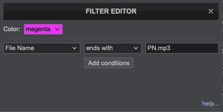

@wickedmix When Platinum Notes has processed a file it adds _PN to the end of the filename before the .mp3 to distinguish it from non-processed files as it always creates a new file and does not affect the original.
All the files in white in the browser have got _PN after the Title in the filename but were not being transferred to the Title field in the Tag Editor.
@IIDEEJAYII that ends with _PN.mp3 logic works, although it should work with the Title field. It seems to be a programming error. Its all my years doing COBOL, BASIC & Assembly Language in the distant past at Uni. But, this is a workaround for now. Oh, incidentally Platinum Notes does not work with video mp4 files, I was a bit disappointed with that as I have over 10k music videos.
Notice the ones with brackets don't have PN at the end as the Tag Editor is not transferring the info from the filename into the Title field.

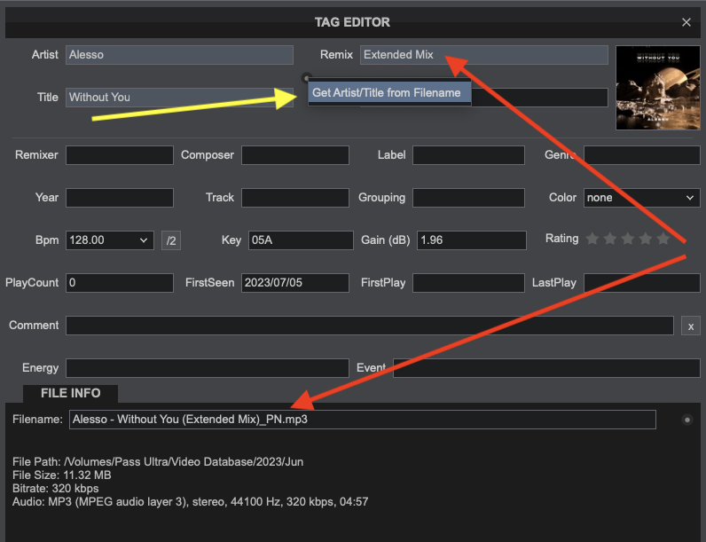

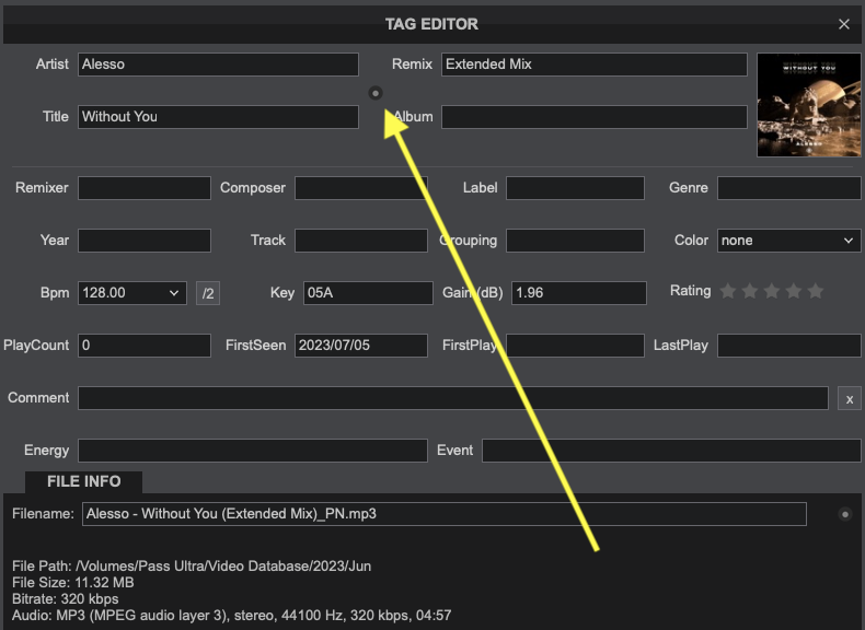

Nope, as I stated above Platinum Notes adds _PN to the end of the filename before the .mp3. Then in the Tag Editor, there is a Dot between Artist and Title on the left and Remix and Album on the right of the screen. There is a command there to Get Artist/Title from filename which is what I have used for years. But, it is not transferring the _PN on files with () brackets as in the bottom picture.

Your issue derives from the fact that you try to parse filename to "Artist/Title"
VirtualDJ tries as best as it can to "guess" the data. So, it extracts Artist (before the dash - ) and puts the rest as Title when there's no remix tag. That why you get "Artist" and "Title PN" on tracks that don't have remix.
However, when tracks DO have remix VirtualDJ cannot simply "guess" what you want it to do.
It still extracts "Artist" before the dash (-)
Then it looks forward until it meets the parentheses. ()
It uses that part for Title, and what's inside parentheses for Remix.
It ignores PN (that's after parentheses) because it cannot tell/guess what info is that.
So, it's definitely not a bug, nor a wrong programming logic.
-Can it be improved ?
-Yes, if the code was changed to allow you to specify filename templates so that VirtualDJ knows how to parse the files and what to expect.
However, due to the nature of what you're doing, the 100% correct way is to check the filename. Since that's what Platinum Notes modify.
So, that's the first step in chain, and that's the most reliable way to capture the condition you want. Even if you could parse the file data correctly..
If you have developer background knowledge, then you understand what I mean! :)

It's OK George, the PN after parenthesis is not a big deal just something I noticed.
The main thing for me is that IIDEEJAYII came up with the Color Filter logic ends with _PN.mp3 I tried that and it works as shown above. It's useful for me to update playlists with Platinum Notes processed files. Thanks for your explanation, I now understand how the parsing works for this.
