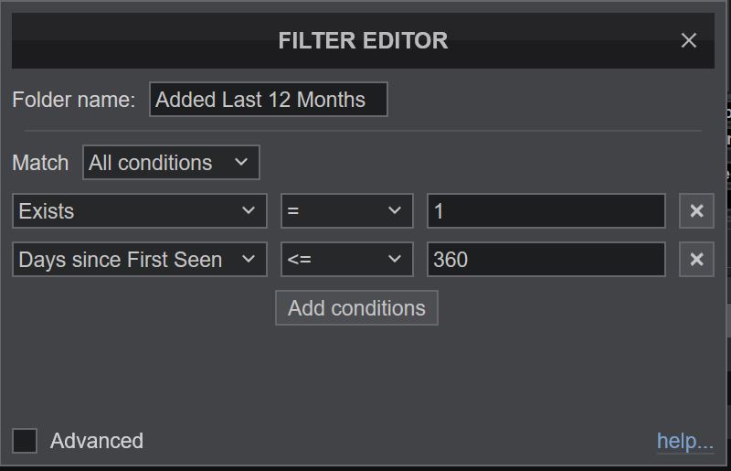

If going by when the song was added to the database, create a filter folder with the amount of days like below.

Thanks. That's one way of doing it. My only concern would be if I updated tags at any point that would reset the song in question.

No as the data is stored exclusively in the VDJ database.
Posted Fri 14 Jul 23 @ 9:49 am
"First Seen" is the date VirtualDJ added the song on the database.
Typically this should not change by modifying tags.
However this would not be much helpful if you started using VirtualDJ 5 years ago, or if you added a 1996 track on your music collection yesterday.
It would make the song(s) still appear in the last decade filter
