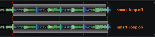

smart_loop is for the length of the loop.
example: you push loop_in wait 4 beats and push loop_out. The set Loop is correct 4 beats long.

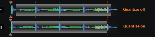

quantize_loop set the start of the loop on the grid (globalQuantize).
example: setting globalQuantize is 1 beat. The Loop is placed directly on the grid.

So that's what those grey markers are for, now I know
