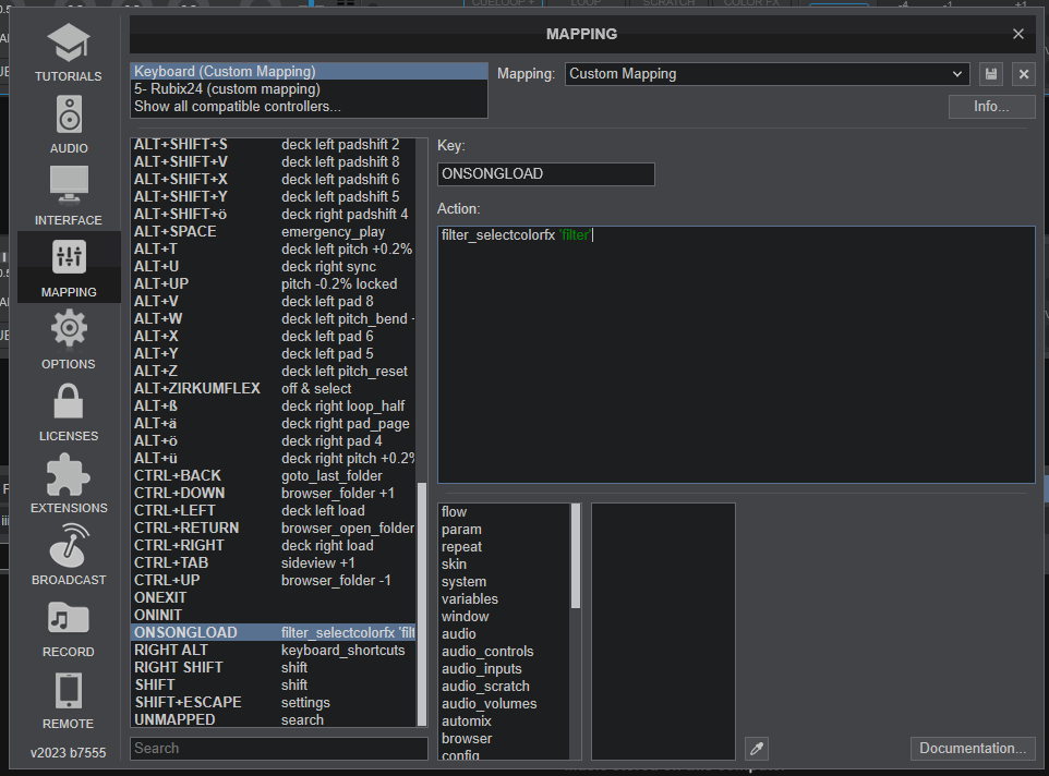

go to the VirtualDJ Option/Mapper and paste to the Keyboard Mapper/ONSONGLOAD
filter_selectcolorfx 'filter'

you are a saviour...
Thank you very much.
