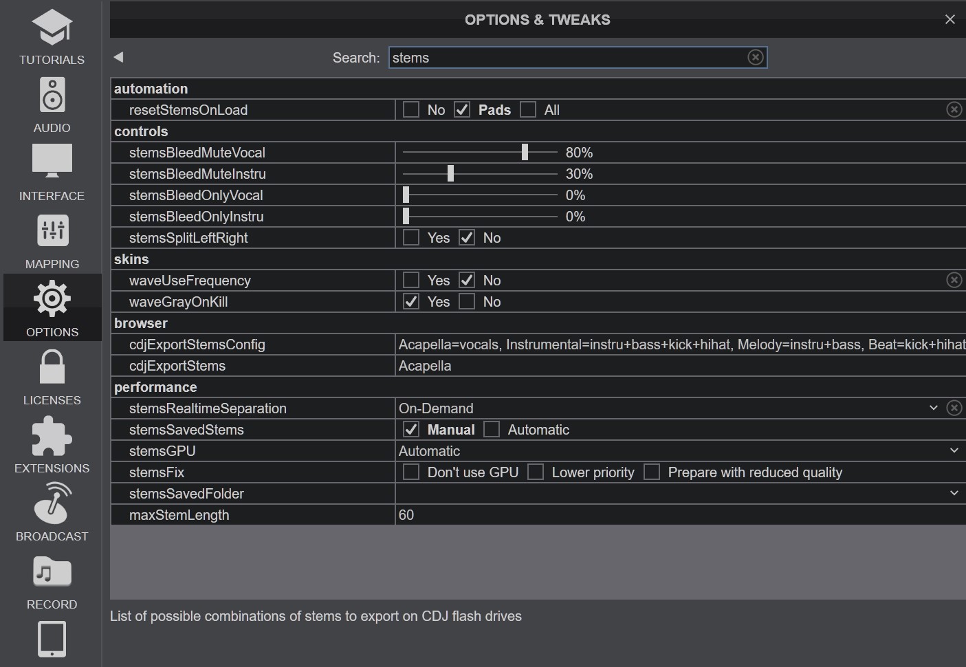

ok being calculated on the fly is what i want. i can wait 5 seconds. so is "always" or "on demand" better?
Posted Wed 24 May 23 @ 9:02 am
and for waves should i have it the frequency set to analyze waveforms to pads. like i had before. or to use stems. and why is it so much faster now?
Posted Wed 24 May 23 @ 9:03 am
didnt see the "store saves stems folder option". thats handy. but i def dont want it on the same drive as my music files. would need to find space.
but on the fly works well.

are the stems now when i try them faster. because "on demand" is a reduced quality?
Posted Wed 24 May 23 @ 9:09 am
If you didn't delete the prepared stems yet they load faster because you have the prepared stems available.
If you did delete the prepared stems already then On-Demand will indeed first start with reduced quality, and then only when you actually mute a stem or use stem eq start calculating the high quality stems.
Posted Wed 24 May 23 @ 9:12 am
ok i really only found a few random ones but. so i should put it as "always" like before for better quality. but i still dont want to save them. my pc and gpu are fast enough its not a big deal
Posted Wed 24 May 23 @ 9:17 am
Always - with on demand you will most like get a popup all the time, when triggering stems

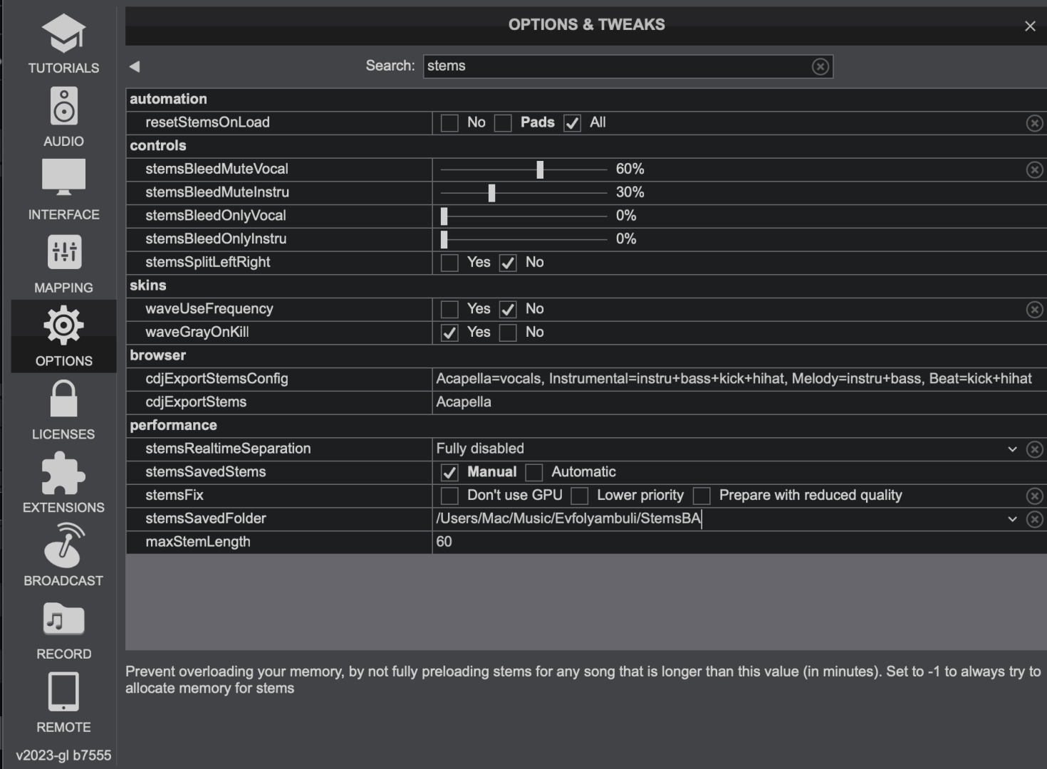

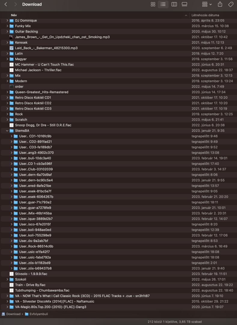

Hi!
Question to stems storing:
I have calculated and stored in a specified folder (user spec. folder: example: BA_Stems) on Mac lot of songs.
Meantime I was connected to my LAN NAS, where I have a copy of songs and stems (the folders practically).
The problem coming if I disconnect from my NAS, VDJ loose the calculated stems, even if I have done and stored on local drive. If I connect to NAS, then all stored stems are visible from VDJ (small icon shows have calculated stems).
After analysing the stems storing method (how VDJ making this) I have seen the following format:
Folder name (in a user specified folder, subfolders): User..1234-???????? 1234 is a last 4 character the songs folder name, ???????? is a hex number.
After disconnect NAS and one song recalculating, VDJ making a new subfolder with the same structure but these last hex Nr are different now, and store the calculated stems file here.
I think this is why not found in disconnected status.
How can we solve this?
It looks if you connect a storage device, VDJ make a Virtual DJ folder and database.xml
Even I copy the calculated stems from the different subfolder, not recognised as calculated stems.
After the last (or maybe some earlier versions too- unfortunately. not checked) update exist this.
It can be surprise if I at home prepare stems (with NAS connected) the go to event (where no NAS) loose the calculated stems.
Maybe I do something wrong, any suggestion would be fine.
(Now if I do calculations must be disconnected from NAS, to be sure have stems away from home.
Thanks,

What is the path of your NAS volume, and what is the full path of the stemsSavedFolder?

kenatti wrote :
maybe because you dont have stems set to always? seems as its fully disabled? and this is the issue?
Posted Wed 24 May 23 @ 6:25 pm

Unfortunately not.
I not want to always start preparing stems. My GPU is to slow for realtime separation (and not always I need it.
So my decision was to prepare at home, where I think is need for mixing, but sure not for all songs.
I think it has nothing to do with NAS (or maybe other storage devices).
Something happens if connected (and store to the correct place - local machine folder).
It was for me a surprise, when I disconnected the NAS (due other reason) then all calculated stems was not showed, and not used from VDJ even they are in the correct folder.
NAS is used for me to have a backup, also the internal database backup from VDJ I copy to this NAS.
And the calculated stems folder too.....1 songs 3 minutes need 3 minutes calculation time (really slow the GPU) like to avoid realtime calculation.
I think VDJ has something not correct handle this, and earlier was not a problem.
I have calculated with NAS connected (via internal network, not directly to iMAC).
Take lot of hours somehow having back the stems files.
The solution was:
- on the not working stems song separation again, then check the folder (fresh created VDJ folder - name is ident except the hex nr) and copy this Nr and rename the folder on the local machine folder to this, then was recognised again.
I was confused for long hour to have back these songs (more than 100) without recalculating again (yeah I had a backup from these on NAS)....now more or less working.
Maybe somebody can look on this, now I am more carefully if calculating stems.....but should be work even connected storage too
