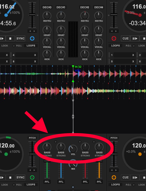

Problem: I have the stem controls set to using all 5 fader knobs per deck for stems control (Gain>Instru, Treble>HiHats, Mids>Vocal, Bass>Kick and Filter>Bass). On my NVII the first 4 work perfectly, but the filter knob keeps working as Filter instead of controlling the bass stem. This holds true both for the original skin as for the one I use, also if I dont use the NVII but just the VDJ screen
Probably just a simple settings problem? Anybody can help?

Should be fixed in Early Access release 7553

Worked like a charm, thx!
