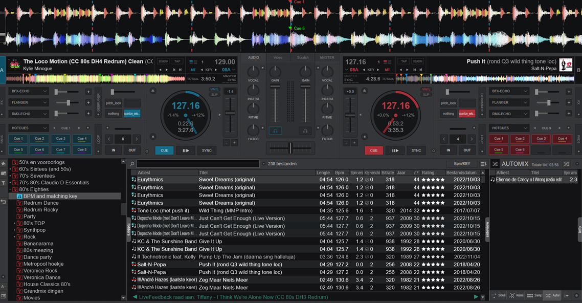

Is it possible to only show up with one song?
I have several subfolders with the same songs in them. when i filter the folder AND SUBFOLDERS one song shows up several times. I was wondering if there is an option in the setting that makes a song (with same filename and date) only show up once in the filter folder. That would make scrolling a lot easier.
I will add a print screen theat probably explains it.

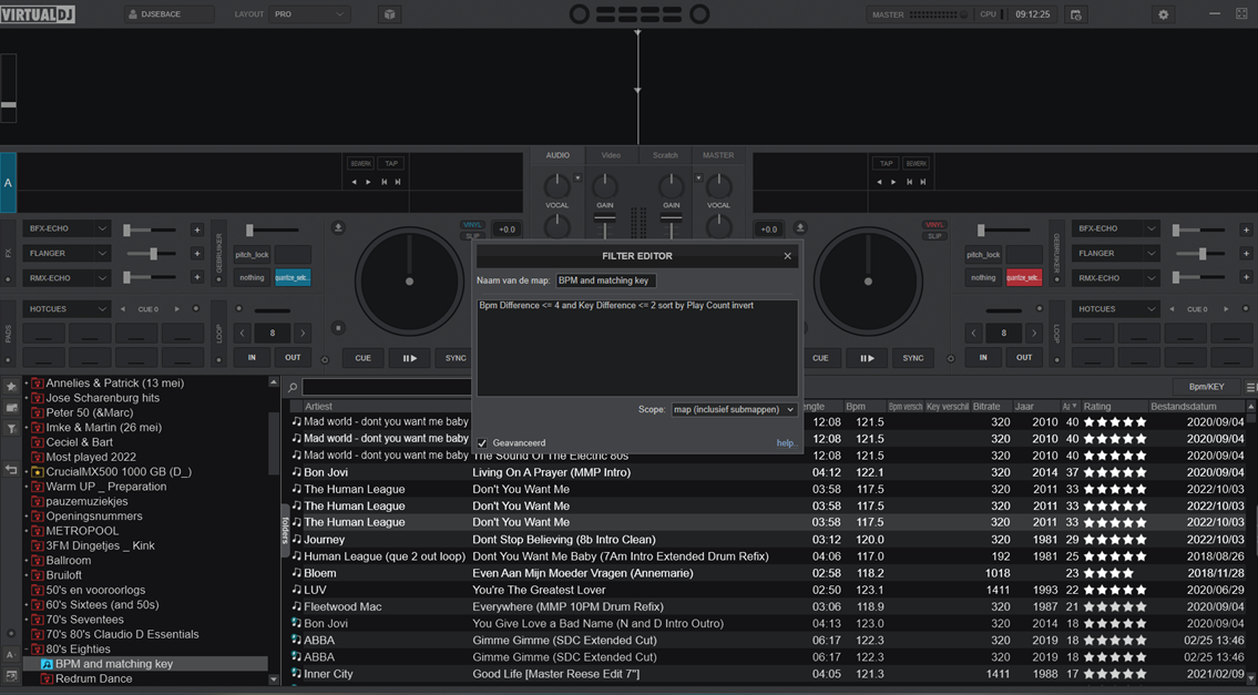

To maybe see where each of the actual files are located, you could temporarily add a "File Path" column, and also the "File Name" column in your browser.
1) Would love to see a screen shot of the same filter results, with "File Path" and "File Name" columns visible.
2) and also a screenshot of the actual filter you are using, with its scope showing
(filter editor's, advanced box, checked, to show scope)

You should mention in your original post that you referred to "Virtual Folders" and subfolders.
From your wording, I thought you meant physical folders/subfolders.
It is true that VirtualDJ doesn't make copies of the files.
Also if the same file is placed inside multiple "Virtual subfolders" then using recurse should only show the file once.
The behavior you describe above is happening only with Filter Folders when the scope is set as "Folder (Recursive)"
Currently there's no way to "fix" that, however I guess it could be possible to include an option on a future update since indeed the file is unique (and not a copy of the same file as I've mistakenly understood)
So, for now (depending on your needs) try to use "Recurse" instead if possible.

SOmetimes it is difficult to explain myself in english and i see where i put you on the wrong feet. I indeed mentioned filename. But in the picture you cabn see that i meant a filter folder within a folder and i included all the subfolders in my filter search.
Now I am figuring out what you mean by Recurse and how to use in filterfolders.

The Advanced Box, (in your photo "Geavanceerd") will show the scope drop-down menu, containing "Folder(recursive)" .
Your pic you posted, did not have that box checked yet. To see how you had your filter folder set.

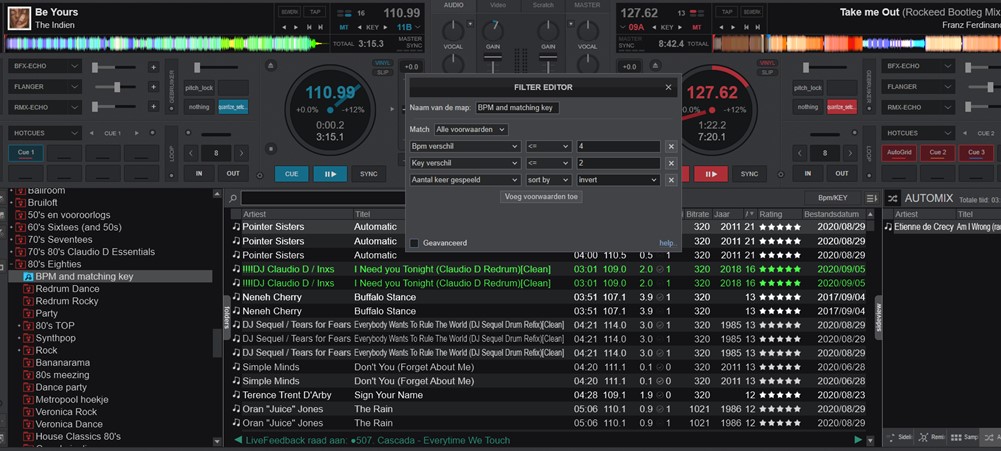

This is the screenshot.
I know the difference between database and virtual folders. I deliberately select virtual folder and subfolders. If i select database then i will get suggestions from my whole database (also 90's 00's techno ,etc), but i only need the ones in my 80's folder and subfolders. If i select database then in de filter selection i can do nothing with virtual folder.
