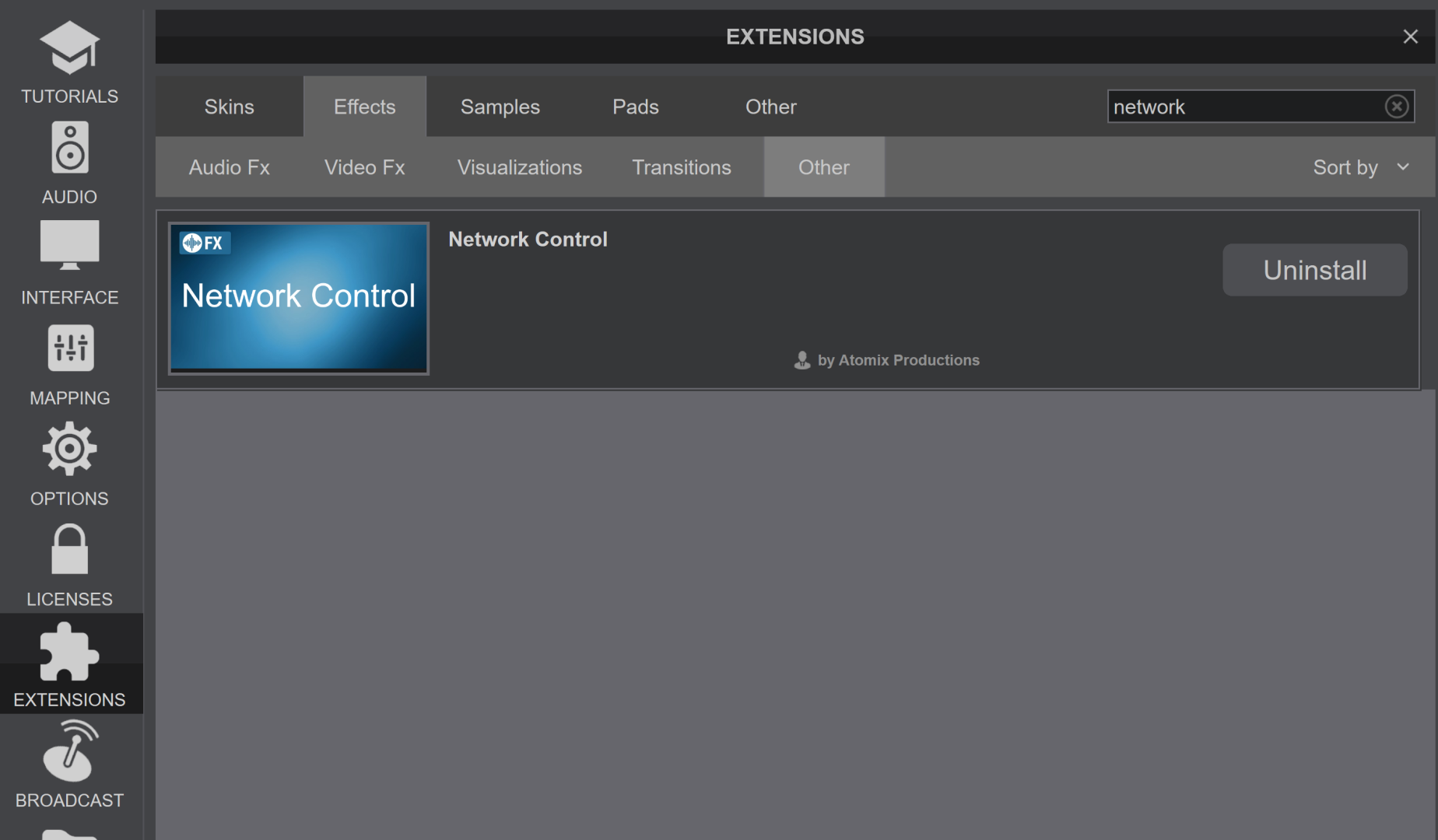

https://virtualdj.com/wiki/NetworkControlPlugin
WIKI wrote :
Installation
To install the plugin, go to Config->Extensions, then select Effects->Other and install the plugin called "Network Control"
Configuration
After Installation, you can find the plugin on the Master panel in the Master Effect drop-down under the Auto-Start category.
There you can use the cog wheel to open the settings.
You can configure the ip port the plugin should use and optionally enter an authentication string to limit access to the plugin.
Configuration

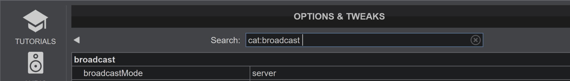

or create a custom button with script:
broadcast
Setting: broadcastMode may also be of interest.
