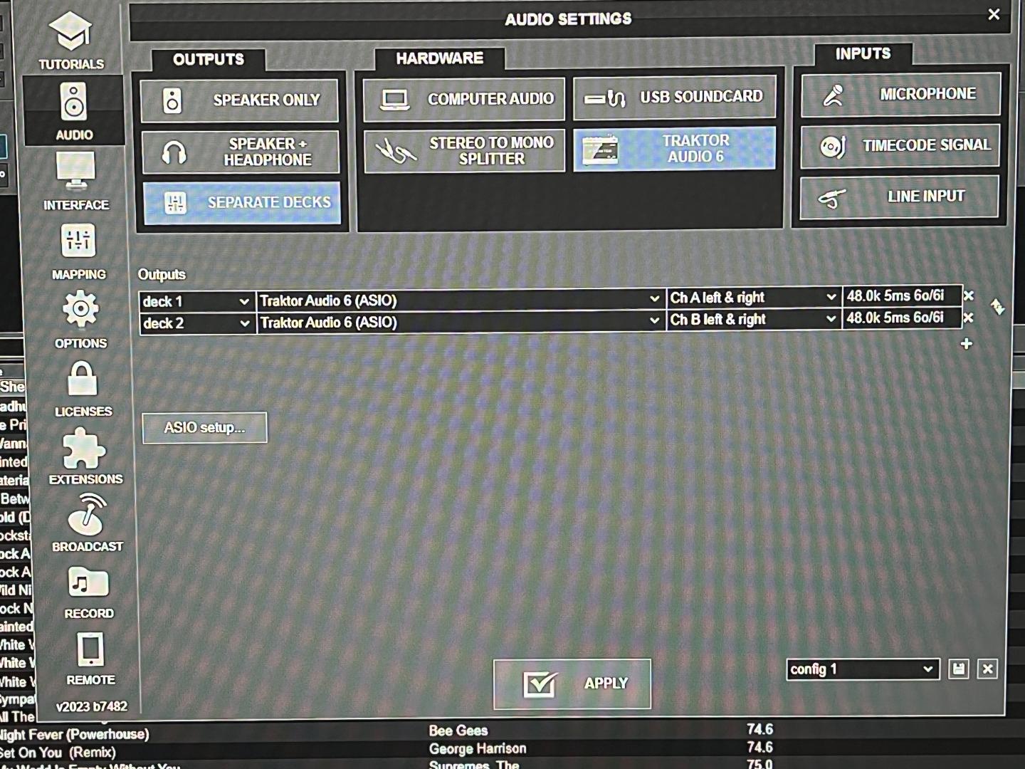

I would think most if not all of the sound cards you listed would be able to be configured to simultaneously output I have an old gigaport that works that way and a newer traktor a6. Depending on how I configure the output they can do two stereo channels Or all four can output the same thing. Can you show us your audio settings in vdj?

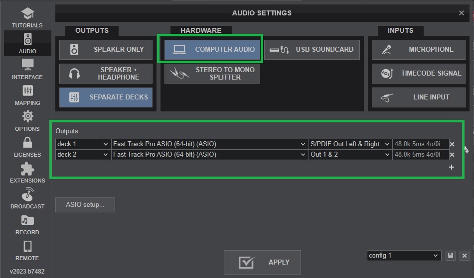

Thank you DJJohnnyROX for the tip to check further. I finally figured out the right configuration for the M-Audio Fast Track Pro so it now outputs the two decks from VDJ simultaneously (see screen grab). These settings are NOT intuitive to me, as I was trying to select "USB Soundcard" (like I was used to with my DJ IO), but it turns out I needed "Computer Audio" for the Fast Track. Also, I needed to select "S/PDIF" for the channels 3 & 4 (deck 2) to work. Who would of thought to use these crazy settings!!??

Strange setting, I would have thought out 1&2 And out 3&4 .... but if it works Great
Posted Fri 24 Mar 23 @ 2:09 am
Actually, I spoke too soon. I thought it was working correctly, but I am getting a very weak signal from the "Out 1 and 2" but the "S/PDIF Left and Right" is perfect. So, once again, I am stuck with an imbalance issue (this time, the whole deck, not just one channel). If I make both VDJ channels use the "S/PDIF Left and Right", I need to use the fader in VDJ to mix (and that defeats the whole purpose). What's weird is that I can only get channels 3 & 4 to playback with the "S/PDIF Left and Right" setting, and I cannot see a "Out 3 and 4" in the ASIO driver dropdown. If anyone can show me a setting that works with their USB interface (and tell me their model), that might help me.

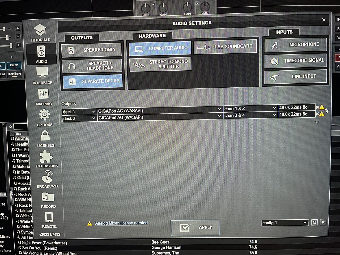

Posted Fri 24 Mar 23 @ 6:52 am

Do you get the option to use wasapi? If so try that

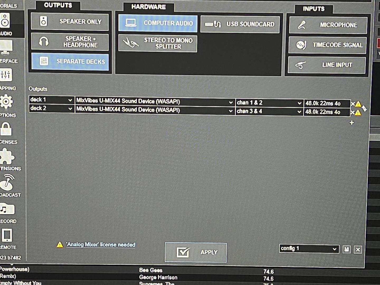

Curious if you've found a solution? I'm faced with the same issue? Numark is not compatible with Wndows 11 and it's always been so good, simple, easy set up. 2 channel rca seperates the decks, Just sent back my M-Audio Air for the same reason! Thought i could just seperate L/R, to deck 1 and 2? Only way i could get it to play like that....is in mono mode! And I'm sitting here wondering what to do? Have an older VMX 1000 mixer.
