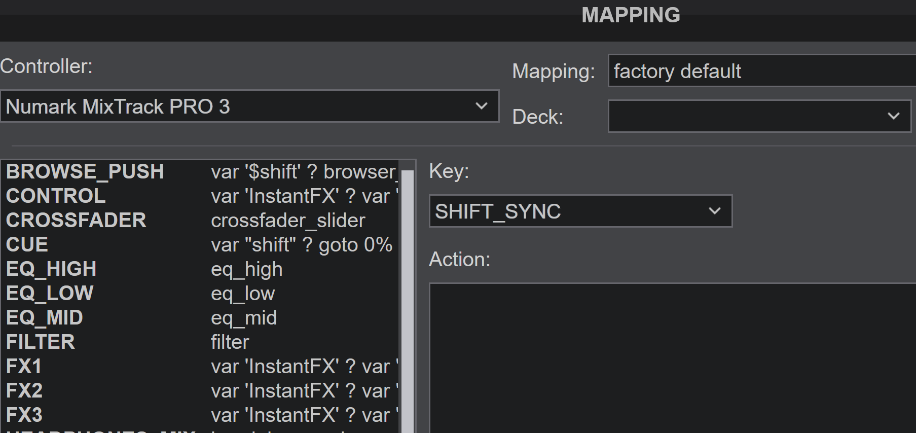

I just got a Pioneer Dj Serato DDJ-SB3 to upgrade from my Numark mix pro 3 and it does not seem like I can pitch reset like my numark could using Shift > Sync. can I pitch reset on the DDJ-SB3 or no?

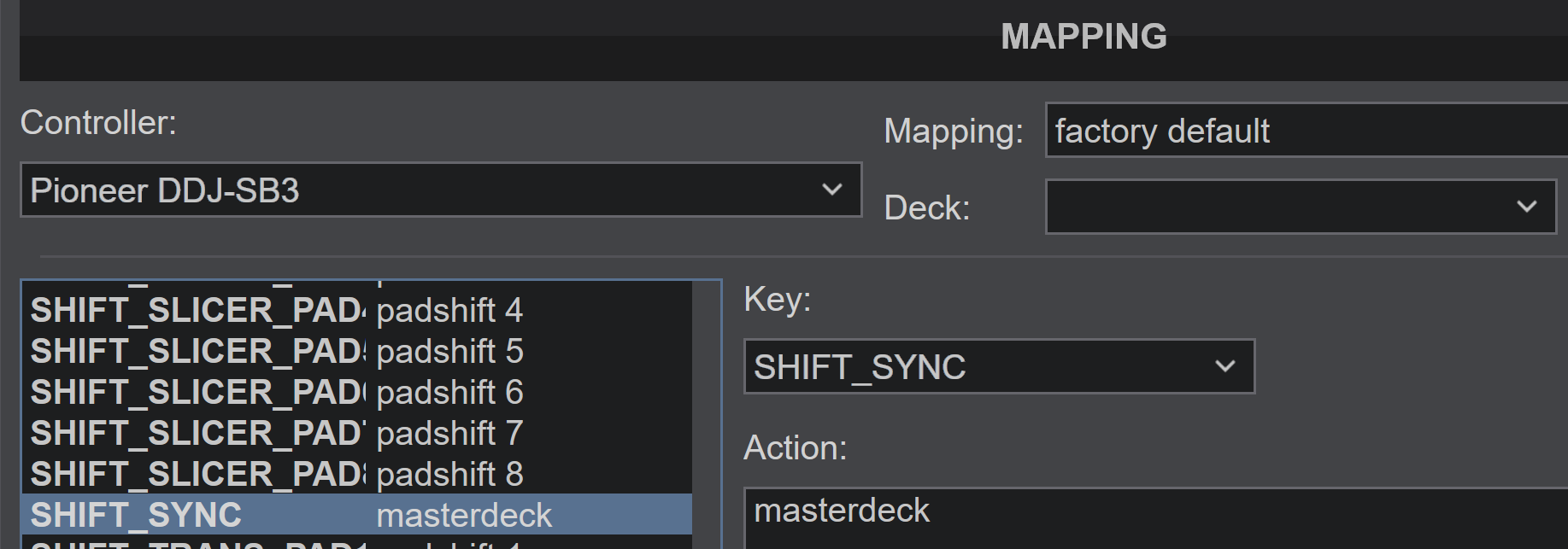

It appears that the new DDJ-SB3 has the Shift_Sync mapped to masterdeck in the default mapping.
and the Numark Mixtrack Pro 3 had nothing mapped to the Shift_Sync in the default mapping.
and you may have added the reset pitch to that button.
You can easily mod the DDJ-SB3 Shift_Sync mapping to either:
1) pitch_zero to reset pitch to zero
or
2) pitch_reset to slowly return the pitch to zero
Hope that helps
PS
the masterdeck selects/unselects a deck as the master deck
