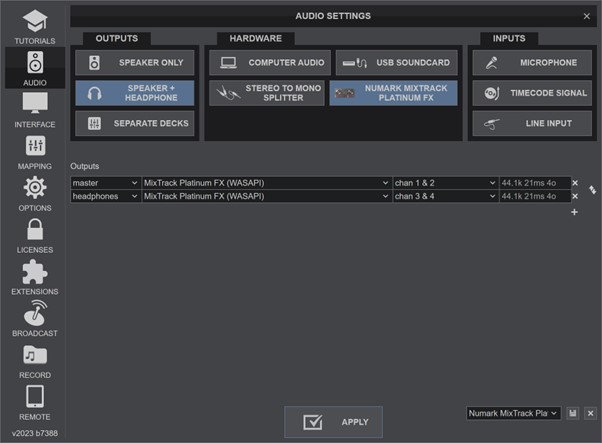

I have just purchased Numark Mixtrack Platinum FX and running it with VDJ 2023 on my new PC which has Windows 11 Home, I7 & 16G RAM. I'm using Virtual DJ Pro demo license.
When headphones CUE is ON it gives sound through speakers whilst volume fader = 0. Also, when headphones CUE is ON then CUE GAIN changes sound in speakers .
Sound for CUE track is also very soft in headphones, seems to favour the track playing.
Hope there is a solution to this, I was so pumped to get into some DJing and now I'm getting disheartened with technical issues.

I had the same problem with Virtual DJ 2025 and the Numark Mixtrack Pro FX. The problem was in my laptop audio settings. (MSI Laptop running Windows 11) I went into my Audio Settings>System>Sound, and the "Mono Audio" setting was turned on, and that was combining the left and right audio channels into one. When I turned that setting off and opened Virtual DJ, everything worked perfectly. The Cue Mix and Cue Gain worked perfect with my headphones. I hope this helps someone because it was frustrating not being able to preview the next song without it playing through the main speakers.
