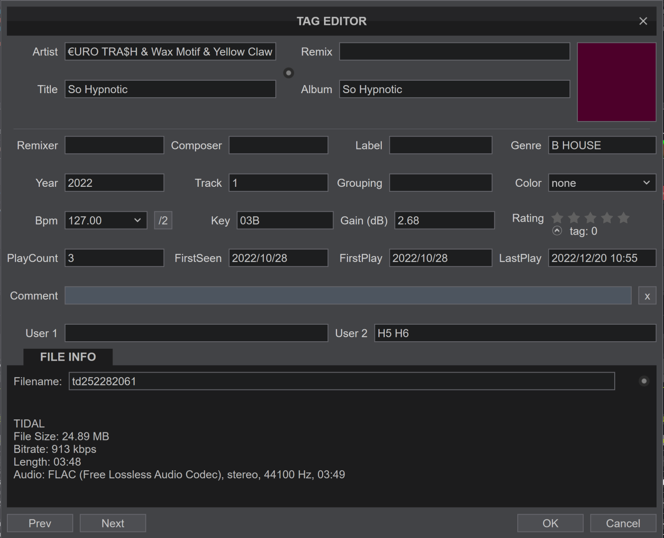

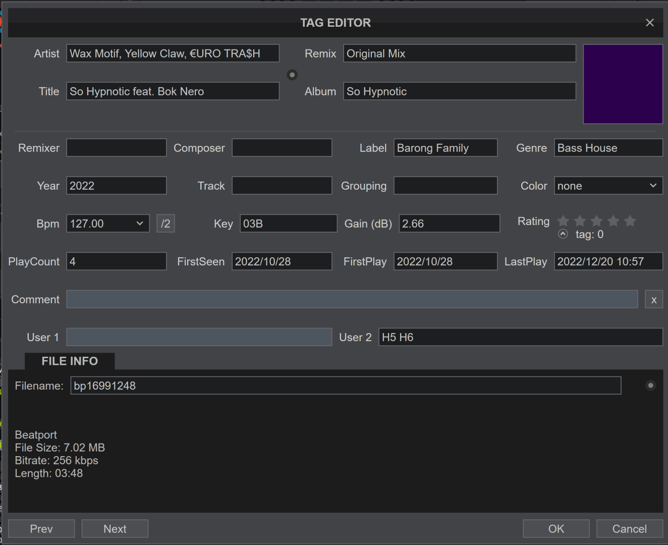

the Tag Info for BeatPort and Tidal tracks respectively(so you can reproduce from same track):

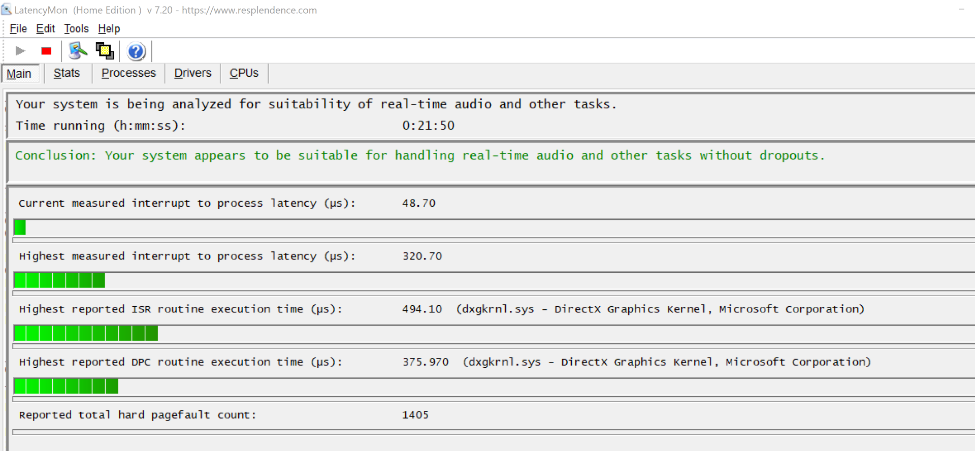

Latency Monitor during the testing time:

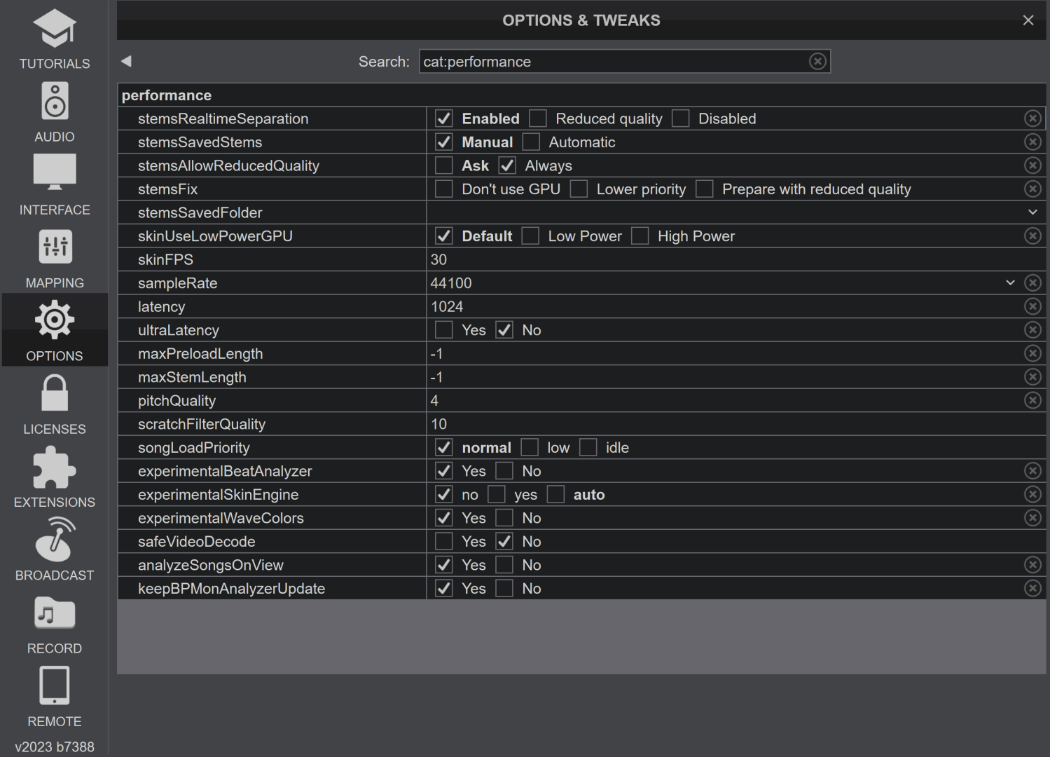

These are the options/settings during the above test.
Note: latency set to 1024, to help possibly eliminate the pops, it is the same if latency is set to the default of 0.
