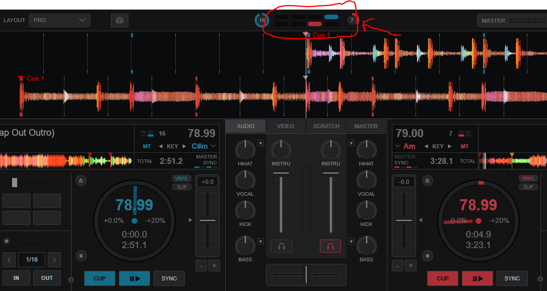

Hi, I am trying to figure how to get beat counter/phrase sync to work via a keyboard shortcut. No luck in the manual. If I use my mouse and hit the red circle that has the 7 in, the red beat syncs with the blue. Is there a way to assign that function to either a keyboard shortcut or map to a deck?
Also a side note, I notice that sometimes I have to hit the phrase button a few times to get the sync to work say blue is on 1 and red is on 6. I have to hit a few times to get 1:1.

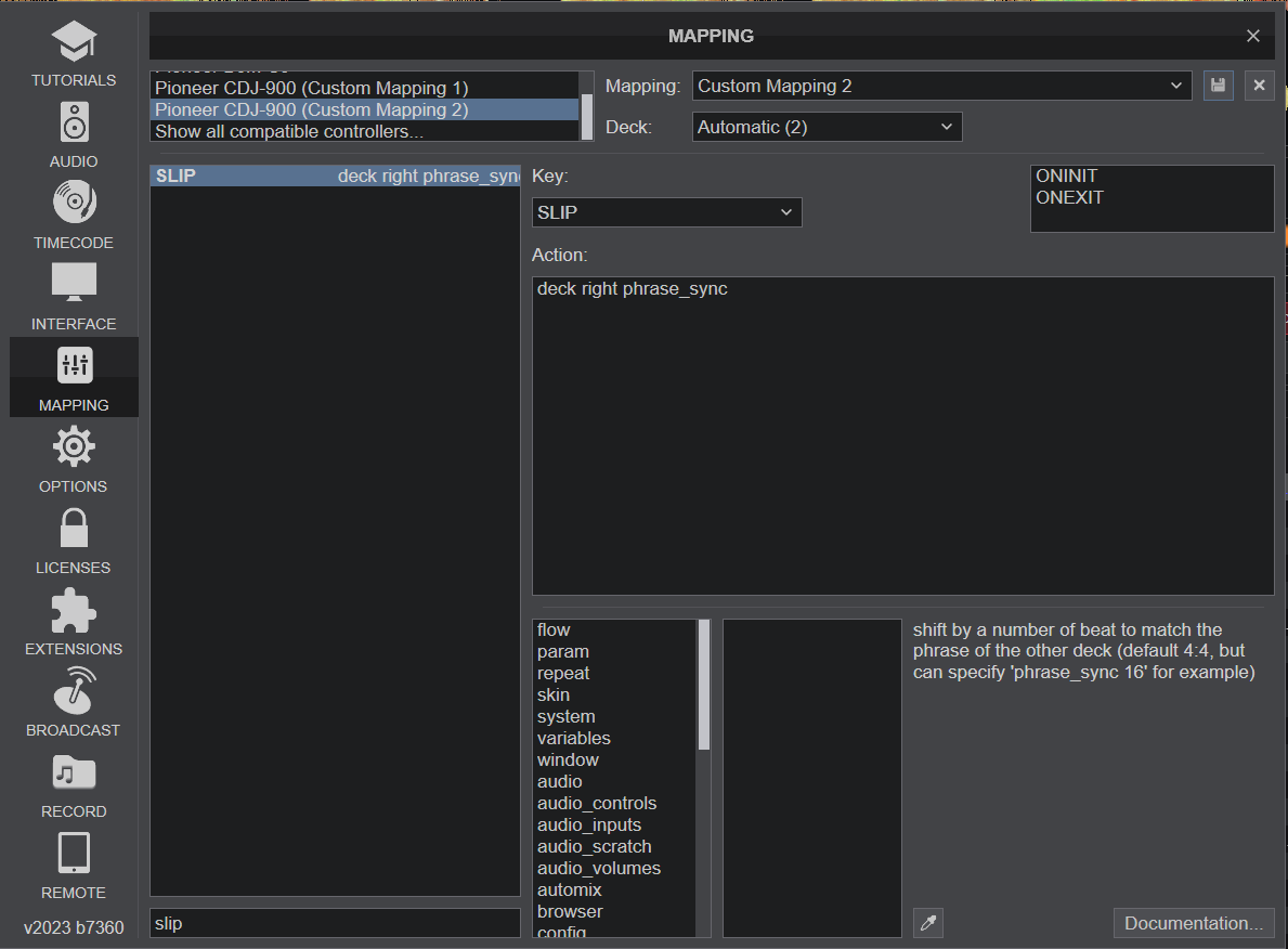

have you use the command phrase_sync ?
Posted Fri 09 Dec 22 @ 4:58 pm
Thanks Dennyo! That worked. I was able to map my "slip" key to "deck right phrase_snyc" and vise versa for the other deck.
