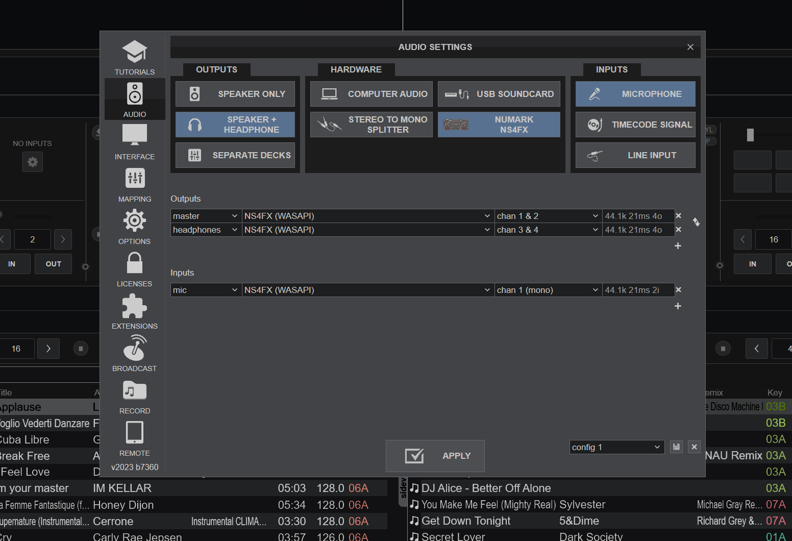

I hope you can help me understand what I am doing wrong when connecting an external Microphone to the Microphone plug or any external source to the Aux of my Numark NS4FX.
After configuring the Audio Settings and enabling either Mic or Line 1, I get this feedback/loop. I tried playing with the settings, but I can't get rid of it. Do you know what it could be?
Attaching image and video that show the problem.

Read the last Note-paragraph from the manual .. https://www.virtualdj.com/manuals/hardware/numark/ns4fx/layout/frontrear.html
You need to remove the mic Input from your Audio setup
