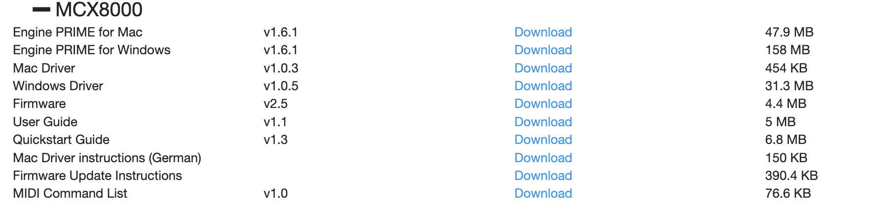

From Denon Support Downloads;
Mac Driver version 1.0.3. for the MCX8000.

The driver is NOT needed.
And i did try downloading the driver, it still does not work.
