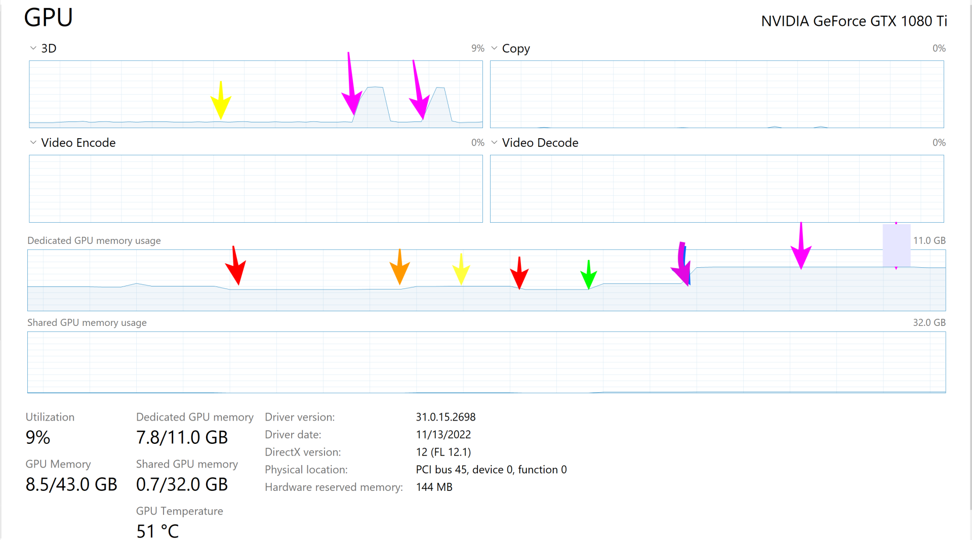

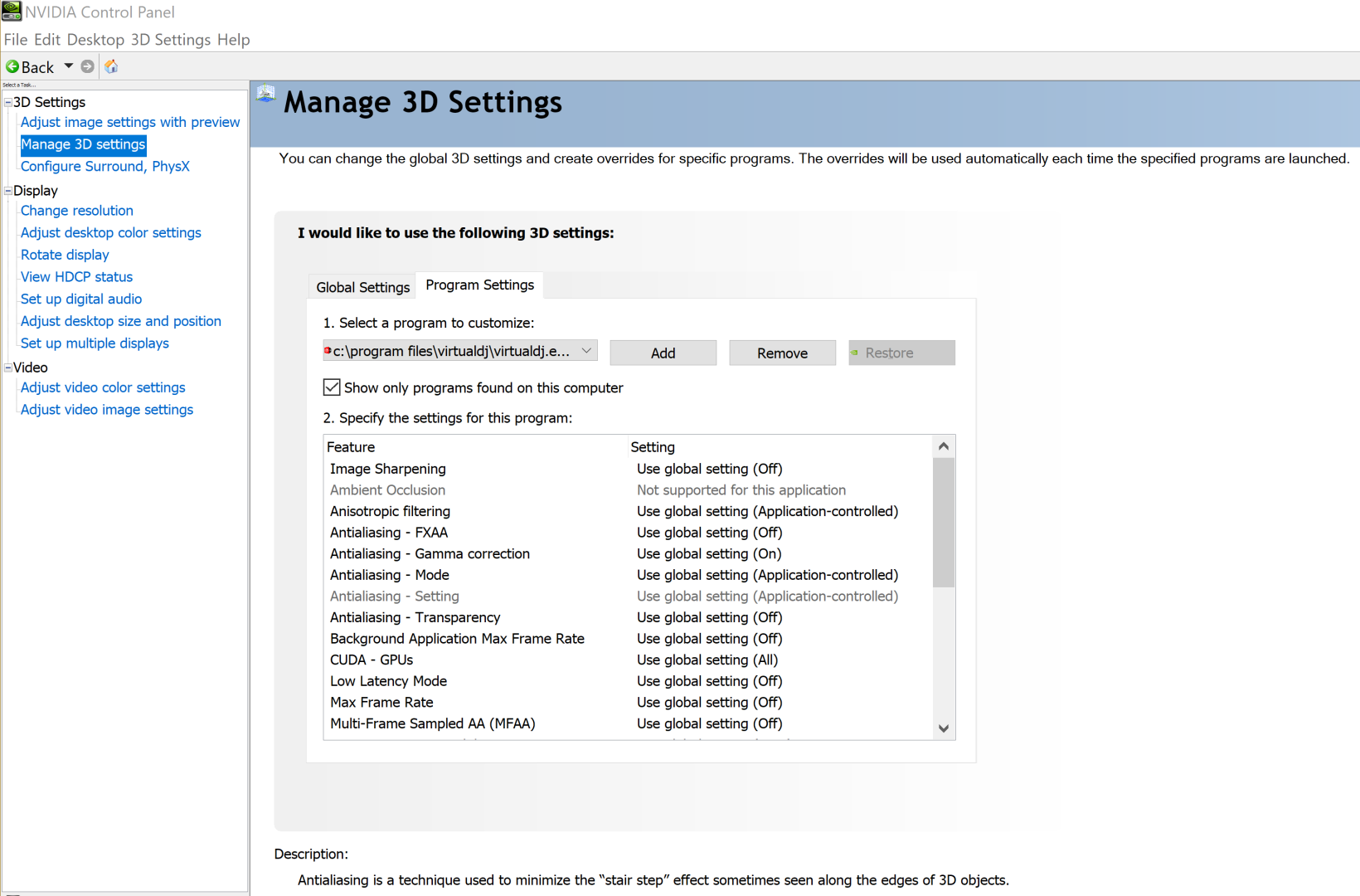

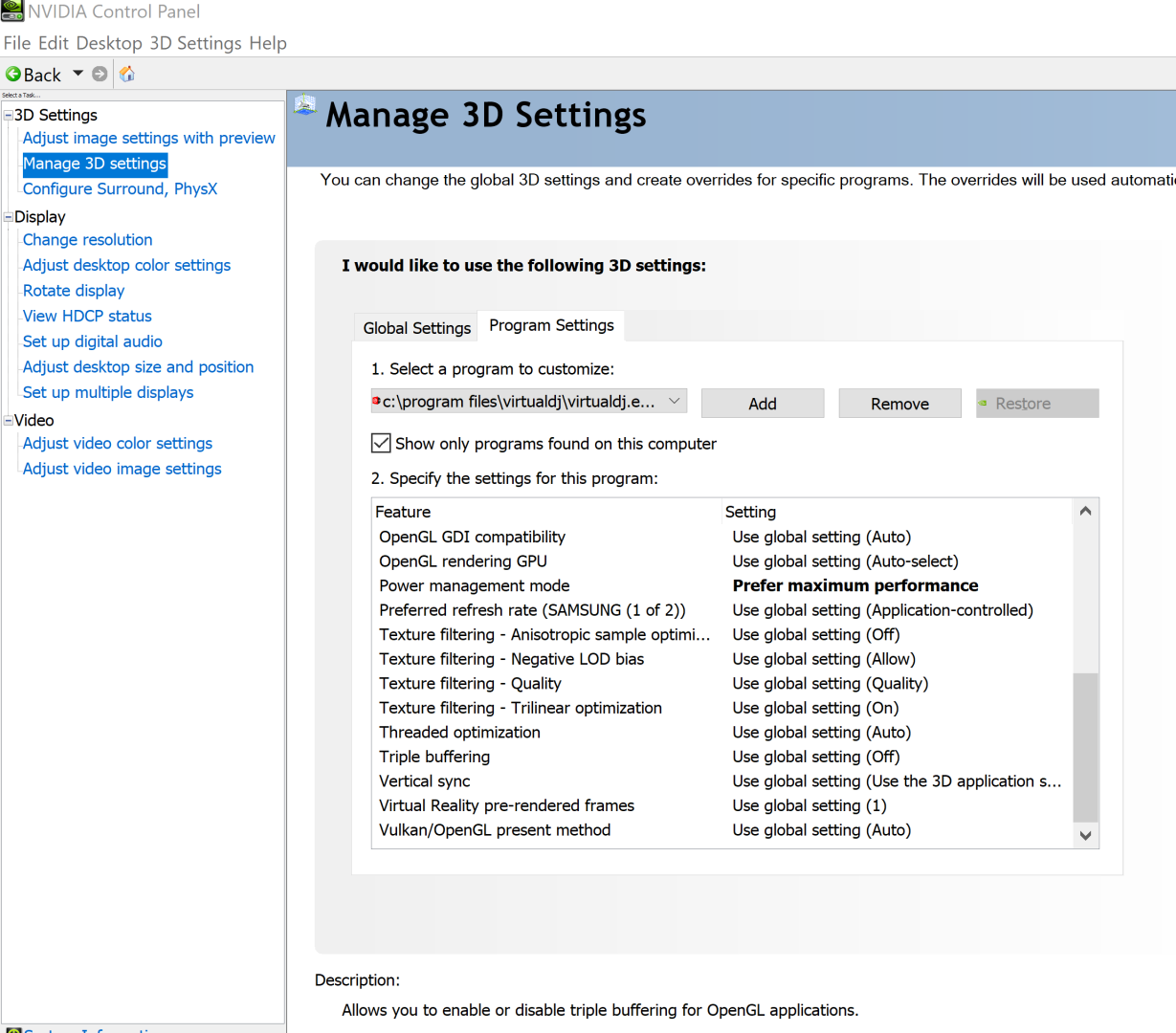

Are there any optimizations on can make, with the Nvidia Control Panel to improve/boost VDJ stems 2.0 performance?
I have only changed the Power management mode for VDJ use.. to "Maximum performance", all others are the default settings.
Asking if there would be benefits from other optimizations?
Don't know which would improve Stems, or which aspects are being used during stems separation.
Screenshots of VDJ specific, settings for GPU

Thank you Adion for your always, "on point" solutions :)
I have been tweaking things to get 2 GPU intensive apps to play well together. And in the past I feel I was running out of VRAM. Since after a reboot the VRAM is 1.6GB then when VDJ is on it increases depending on mode. (here is graph created a few weeks ago)
Red Stems OFF
orange stems 1.0 ON
yellow load track to deck stems 1.0 compute <<< No noticeable impact on GPU, which puts in perspective, the GPU load, needed for Stems 2.0 separation
green stems 2.0 turned ON
magenta load track to deck.. 2.0 compute
And have at times, another app, that would like 6.5GB of VRAM. and would love to have this app use the "shared" GPU memory, if that is possible.
I have since tamed this apps use of VRAM, a bit .. and now allows VDJ to NOT switch to "Don't use GPU" mode, or to create, Stems engine errors. So all is good, at the moment, and always wishing to improve if possible.

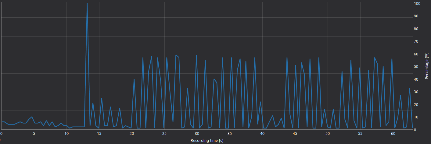

Hey !
VDJ seem to use specific ressources of graphic card
I have an RTX 4090 and computing stems take long time, but little faster as my previous RTX 3070
But analyzing my main library of ~4k tracks take more than 24h...
Taking 10 minutes for 50 tracks is so long

I assume that is a plot of GPU usage (% of max) vs time in seconds.
And if that is true, then it appears that your systems is computing about 8 tracks every 10 seconds, or about 48 songs every min..
(and this even includes the read and then the write to storage, times)
which is amazingly fast, my opinion, especially since tracks cued to be prepared, are a bit slower then then when they are loaded to a deck.
(assume that is done intentionally so that the GPU is not over worked for hours at a time.)
Why is it taking so long to do 4K tracks, at the above rate it should take less then 2 hours.
(if my math is right)
gpu peaks and troughs don't have to mean a new track, he said 50 tracks in 10 mins, 12 sec per track
Posted Thu 26 Jan 23 @ 2:05 pm
Yes that is what he said, and was attempting to interpret the graph.
(on my system, each peak is a new track being processed by the GPU, see the graph posted above in this thread, Dec 14th)
Expecting the currently most powerful NVIDIA GPU, the RTX 4090, to outperform my GTX 1080 Ti, which calculates 2.0 stems at 2.8s/min of track. (so about 8.4 sec for a 3 min track, 11.2 sec for 4 min track)
(ie was hoping the RTX 4090 would be 8-10X faster then the 1080 Ti)
And if the the RTX 4090 takes 12 seconds to prepare a single track, then that indeed, is not great for the RTX 4090 GPU.
Would love there to be a thread where times are posted for each of the typical GPUs/VRAM combos, so everyone could have better idea of what to expect from their current or future systems.

1080 can be up to 20x realtime
2080 27x
3080 48x
4080 62x
At these speeds, it's of course not very useful to save precomputed stems in the first place, but if you want to do it, the time it takes is probably limited by saving the precomputed stems itself, which are encoded using cpu.

looking at your graph I would guess it maybe about 1 second, right ?

I have a RTX3050ti and tried all settings the Nvidia 3D config but none makes it quicker, a 5 minute songs take about 4 to 5 minutes compute the 2.0 stems. If i use only CPU it is quicker, about 2-3 minutes to compute.
I have the 7474 version wich should be using a combo of CPU and GPU? (hence the "Allow partial GPU acceleration with RTX3000 with 4GB memory") but it doesn't do that, it uses standard all GPU. To bad it doesn't use the memory available to the max (2,9 dedicated of 4 GB and 1,6 of 7,6 shared)
Btw forcing VDJ to use Nvidia card via the Nvidiaa config doesn't make a difference in performance.
All in all pretty disappointed with spending €117 for a licence and not able to use stems 2.0 the way it should be. Imo an AMD 7 Ryzen gaming laptop with 16G memory and RTX3050ti should be able to work fast with VDJ,
