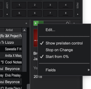

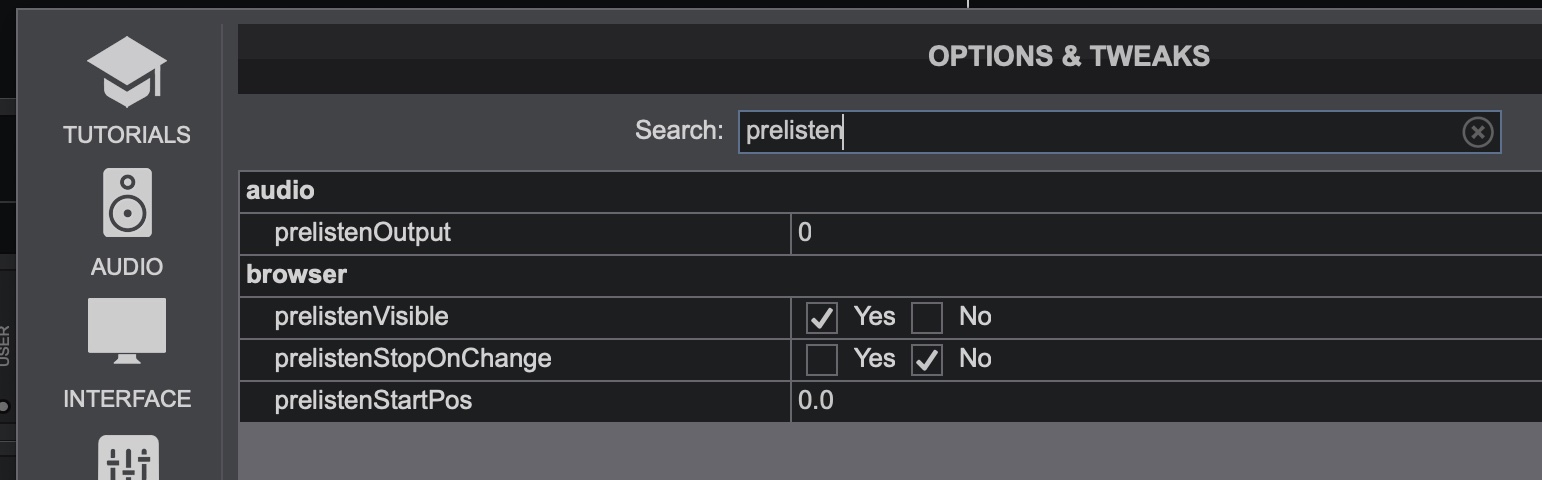

With the latest update (01-Oct-2022, v8.5arm b7151, previewing songs from the record case, side list, etc, no longer starts at the beginning of the song. It just picks up where the last song was playing.
In the Options and Tweaks area, PrelistenStartPos = 0 and the line option in the Prelisten functional area is set to Start from 0%. Screen grabs attached. I am using MacBook Pro. I have verified that VDJ has full access to read and write to my computer.

In update b7161 the prelistenstartPos is not yet OK. When set to "0", during playback of a subsequent song, the start position is not "0" but approximately where the previous song was interrupted. A workaround for me is to enter not "0", but "0.000001" so that the actual 0 position is reasonably approximated. By the way, -1 (default) is a mystery to me.
