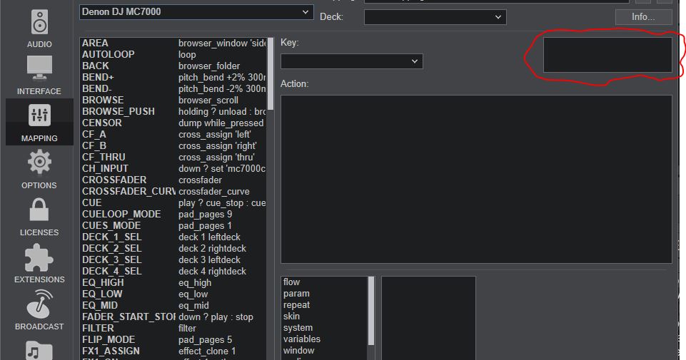

Unless it's 100% hardware based (and I don't think it is), you can check the MIDI commands coming in, and see if it's from one or multiple faders.
You do that in the little midi box in the mapper window:
Posted Sun 18 Sep 22 @ 5:50 am

I've checked this and moving the fader just displays "Volume" and the value, all faders the same, there's no fader 1, 2, 3, 4. No new entry for moving a different fader.
