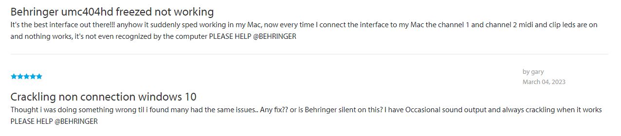

So probably not a VDJ issue then, but rather a driver issue
It looks like it's a pretty common one:
From here: https://www.behringer.com/product.html?modelCode=P0BK1
Have you tried contacting Behringer?

netster wrote :
I got in contact with Berhinger, who are making the point that if the interface is working fine with other applications (which it appears to be), they are suggesting it would be the VDJ software? I see their point, caught between a rock and a hard place it seems.
It seems that's not correct
I'm not saying that Behringer is lying - but they maybe haven't connected the dot's yet, if it's something like an OS update causing it
Because the latest reviews (both from this month) on their own homepage for the unit are about similar issues - and that's not from VDJ users:
Form here:
