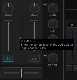

Here's the VU Meter tooltip, taken at a high peak:

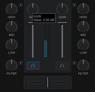

Here's one with the Gain tooltip:

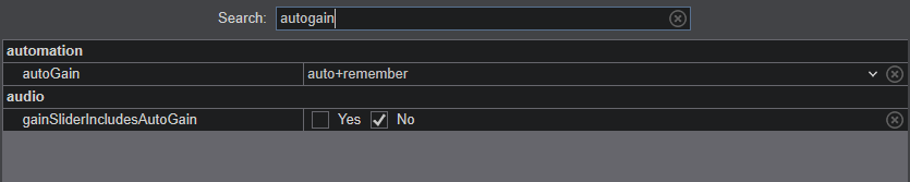

Here's my settings (I had Autogain enabled at that point, and by default I have gainSliderIncludesAutoGain to off):

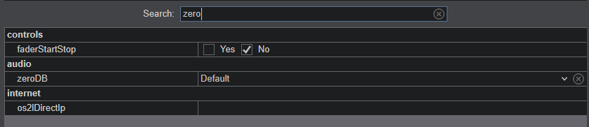

And here's my zeroDB settings, haven't touched it after:
