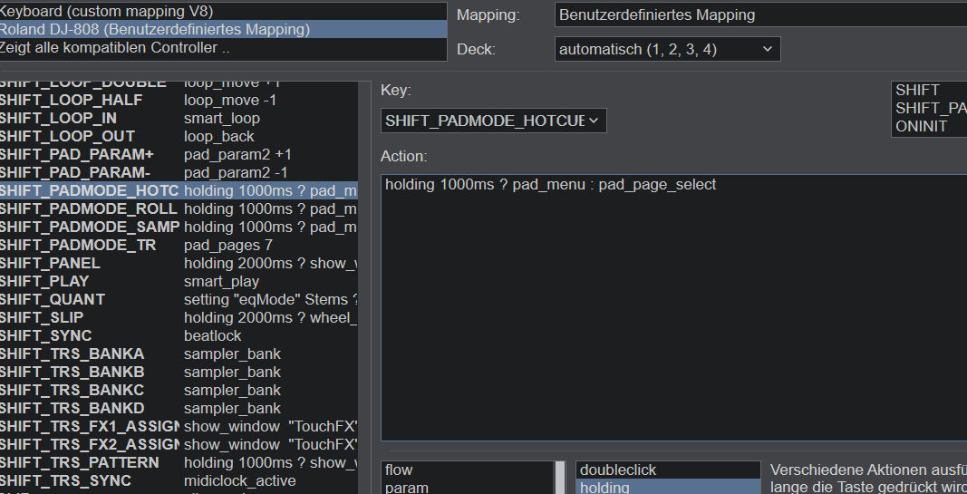

I created the following commands in my mapper for my Roland for the padpage selection buttons.
Example when I press Shift as follows:
Holding 1000ms? PAD_MENU: PAD_PAGE_SELECT
This no longer works.
However, if I take out one, either just holding 1000ms? Pad_Menu,
Or just,
pad_page_Select,
Then the command works.
Before it went, but unfortunately I no longer know which update is no longer possible.
What have you screwed up again in the programming?
It will probably not be due to the controller.

The space between the individual words in the command is correct, that was probably just due to copying and pasting, see screenshot.

Indeed the script above will not work for the Roland 808 anymore. There was a conflict in firmware and Split pad pages, and we had to remove the "up" check.

A button has 2 states down & up, it only sends it's state to vdj when it changes.
holding, needs both, down in vdj starts a timer and that checks if it has received an up message within the timer limit, if has received a up then it preforms the press action, if it hasn't then you are holding and it does the holding action.

I tried to find the Forums topic where the issue was reported but no luck. Anyways, the issue was introduced when we implemented Split Pad pages https://virtualdj.com/manuals/virtualdj/interface/decks/decksadvanced/pads.html#split
Unfortunately, we had to make a change in Mapping files and the Pad mode buttons (and only these) to avoid Pads get stuck at a page during a certain key combination. So it's not something that was broken in some firmware update, but a bug that was revealed after we added the ability to split/combine Pad pages.
With the change we did, the action assigned to the Pad mode buttons are executed immediately on key press and doesnt wait for the "up" (release) of the button, which makes the actions like holding ? , up ? , down ? , while_pressed etc and Split pad pages not working.
