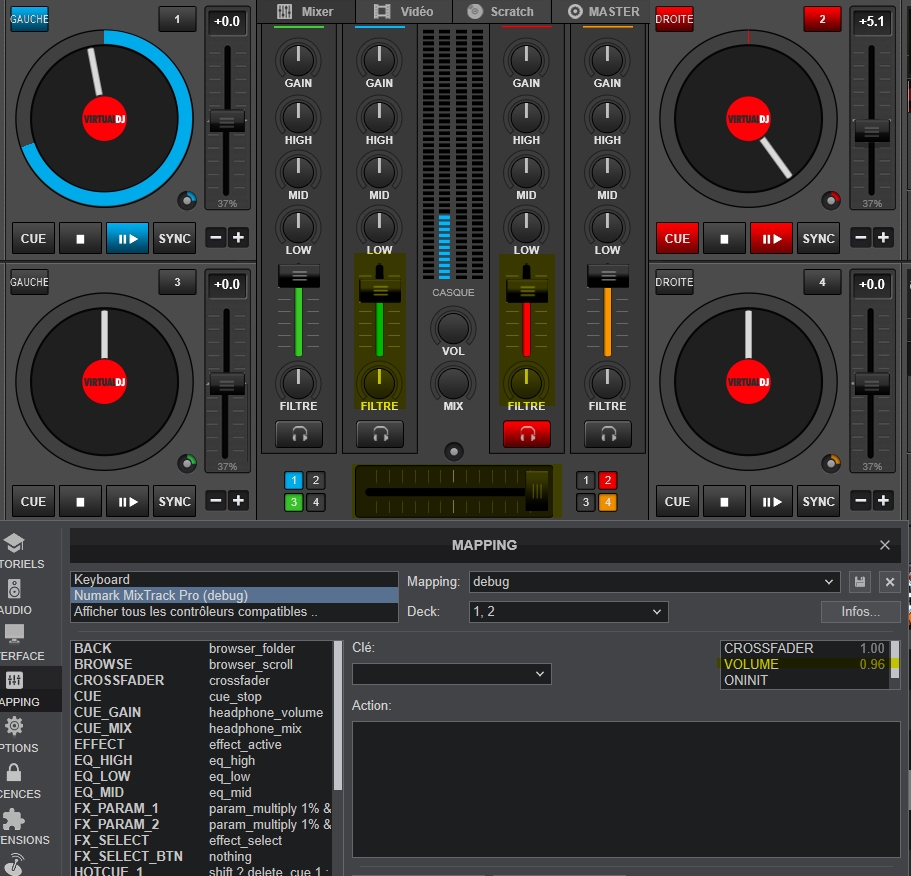

Hello,
I have a Numark Mixtrack Pro.
When I push the crossfader on the right, the volume decrease to 0.96 for both deck.
The crossfader is set to "scratch". I have no problem with the other controler Numark Mixtrack (not the pro version).
It's like this controller control the volume by default.
Do you have any workaround or a mapping command to fix this bug ?

If you have the CROSSFADER key mapped as crossfader and VOLUME key as volume then Mapping is correct. The Crossfader Curve selection is irrelevant.
Most likely it's a hardware fault. e.g. the physical Crossfader faulty sends some Volume Midi messages when reaching the far right position. You could probably check the faulty behavior by using some MIDI app like MIDI OX and then consult Numark support for a Service point near you.

So I checked with MIDI OX, the cross fader send a bad signal when you put it in the right side. It's look like it send 2 commands instead of 1.
I will check to buy another crossfader or I will throw the controller to the trash...
Thanks for your message.

Also I have an Idea,
I can create a mapping "When crossfader is on right side, dont change the volume or set the volume to the maximum"
I will check this...
