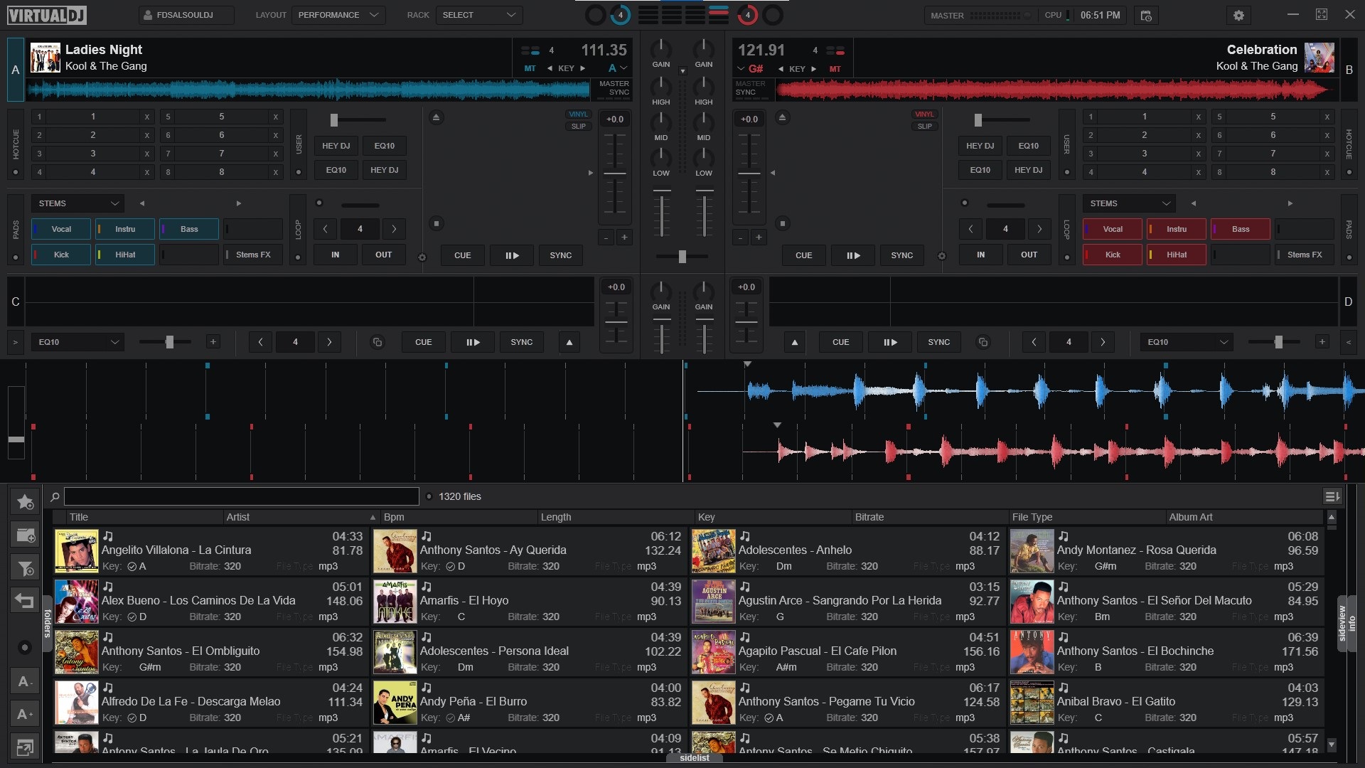

Nothing changed on my END. Just wondering what the heck happened to the Default Skin after I upgraded to V6839. Is it a Bug? Photo Included, Check it out.!!!

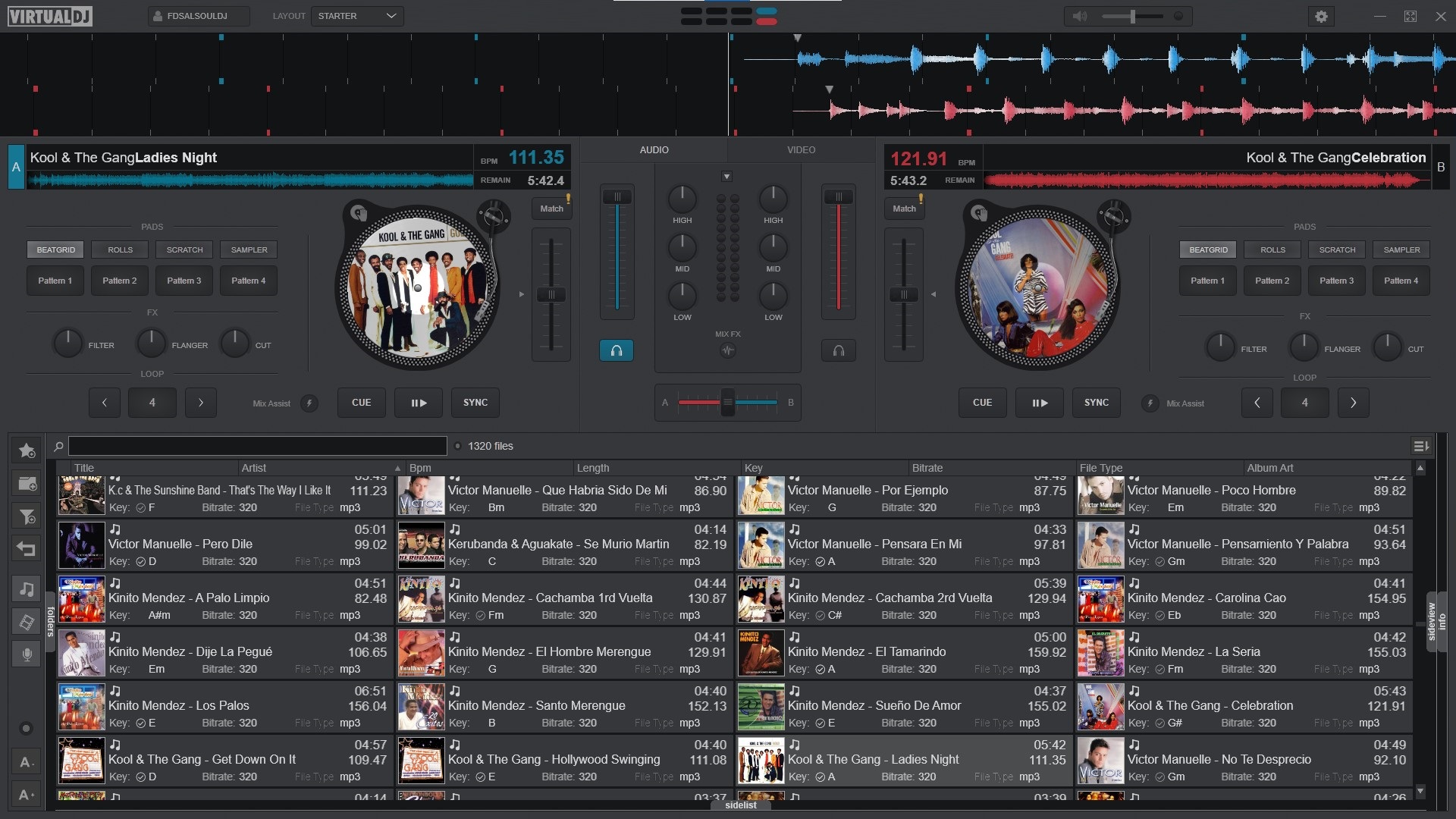

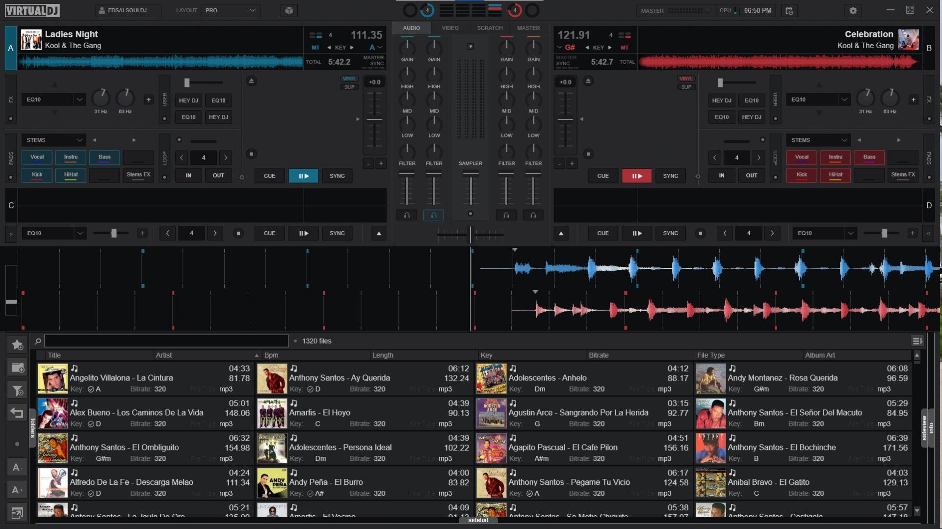

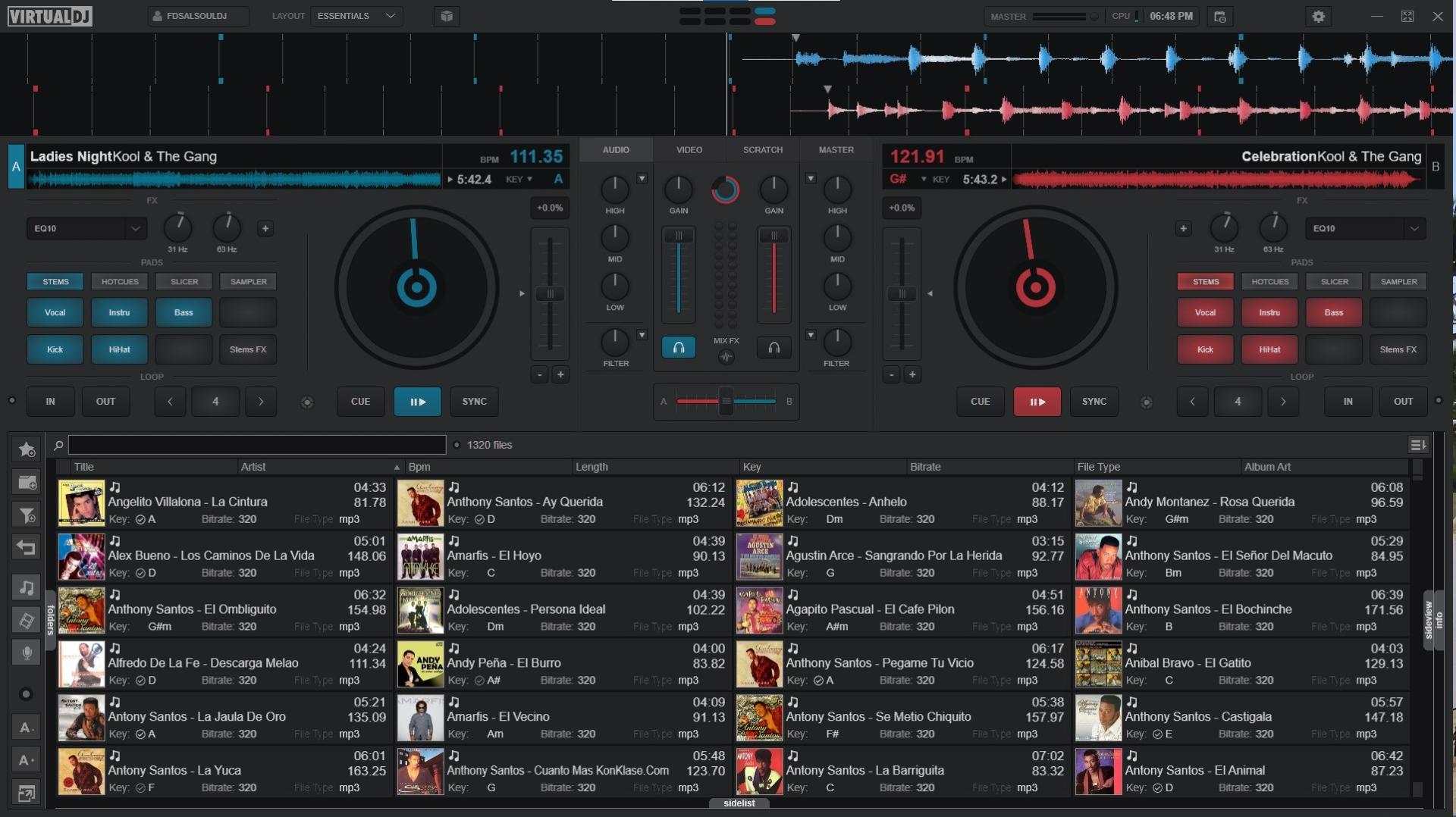

Adion wrote :
Might help if you tell what is messed up exactly
Hi. As shown in the Photo the Jogwheel on the PRO and Performance are Gone but are visible on the Starter and Essentials. Thanks for the Replied.!!!
Posted Mon 07 Mar 22 @ 3:13 pm
check your var list [with the script, var_list]
what is you value for @$spinner [just curious, but it must be where the fault lies]
you can fix it with either this script, or selecting a jog type from the skin layout options.
set '@$spinner' 0
set '@$spinner' 0
Posted Mon 07 Mar 22 @ 3:26 pm
