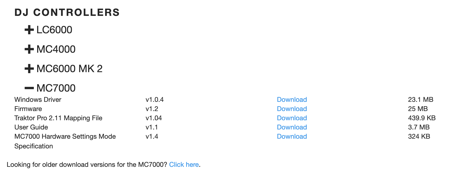

I have owned my Denon MC7000 Controller for around 3 years and never had any problems like you are experiencing.
I did notice your reference to your latest firmware and didn't recognise it. A quick check of the DenonDJ website and this is the firmware (v1.2) that I installed 3 years ago in my MC7000;
Go here
Go here
