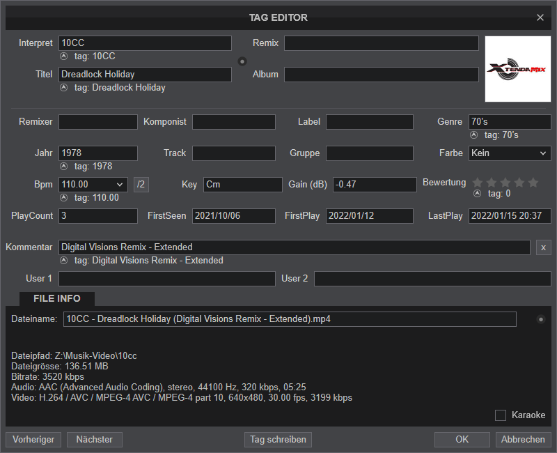

Doing a test with a mp4 video file:
Before, take a look at tag YEAR in the tag editor:
Now I changed that value external with MP3TAG to "1988", after that I marked the song in the VDJ browser and did the "BPM and TAGs ermitteln" (sorry, german) from the context menu:
Nothing happens in the browser view, so I open the tag editor again:
As you can see VDJ has seen the change ("1988"), shows this below the tag information which it is the value from the database ("1978"), but there is no update until I push the arrow button ... and that's really illogical.
Now how I can configure VDJ to read and import new or changed tag values???

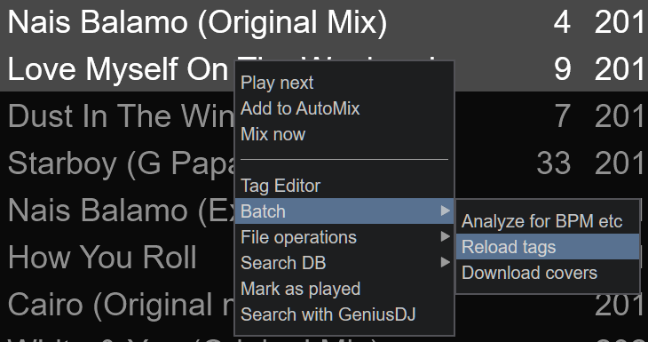

As I said, you need to select AT LEAST TWO TRACKS and then use the BATCH menu.
Not the "Analyze for BPM"

Thanks ... that is it!
