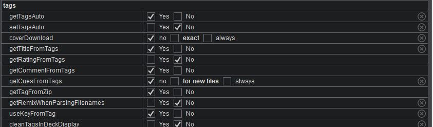

I think you need to change your workflow. It would help if you analyzed your new tunes before all the other processes, this is my workflow;
1. New songs are loaded into a monthly folder for each year on my hard drive. On refreshing that folder in VDJ, any new tunes are analyzed by VDJ.
2. In the next step, I use Platinum notes to process that month, only new tunes are processed.
3. Then I load that month into MiK and process them for BPM, Key & Cue points. Again only new tunes are processed.
4. Then I use OneTagger/Auto Tag to process that month to correct Tag info, spelling, names, etc.
5. Only then do I highlight that folder and Reload Tags in VDJ.
I've never had a problem using this workflow weekly.
These are my settings;
Posted Sat 16 Mar 24 @ 8:27 am

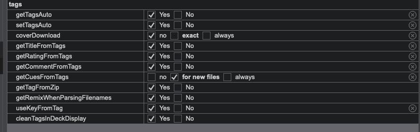

Here are mine:
Posted Sun 17 Mar 24 @ 12:27 pm

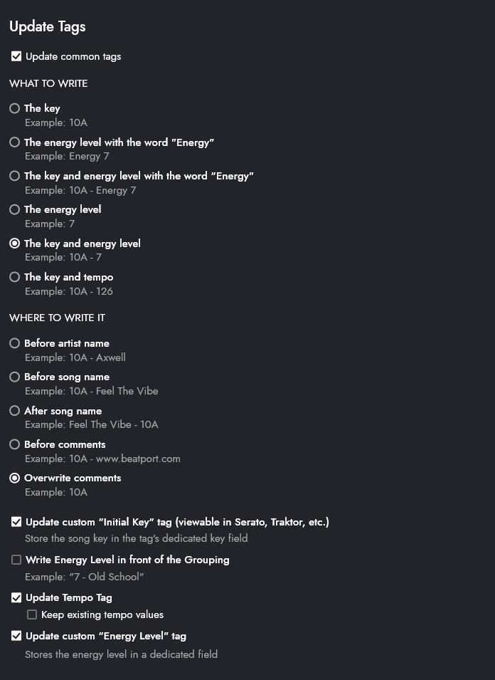

you seem to have your VDJ settings correct but how have you set up mixed it key?
mine is working fine with these settings.... of course i always scan files before VDJ sees them
just a NOTE i am writing the comments filed with key and energy so i can confirm the key info and see the energy info in VDJ
Posted Sun 17 Mar 24 @ 1:30 pm

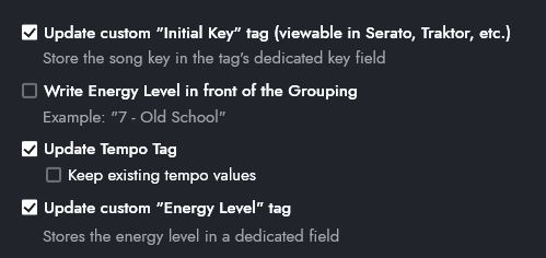

I'm only writing the Camelot Key information and Energy into the ID3 tags.
I don't even care for 'Energy', but the Key information is useful.
Here are the only options I have on, for Mixed In Key.
My issue is not Mixed In Key, but VDJ, sometimes ignoring the ID3 tags.
It's the nature of my "issue", ie. it's not consistent enough for me to find patterns.
So, that's why my issue was reported many months ago
and why I just noticed this recently, hence coming back to this thread.
