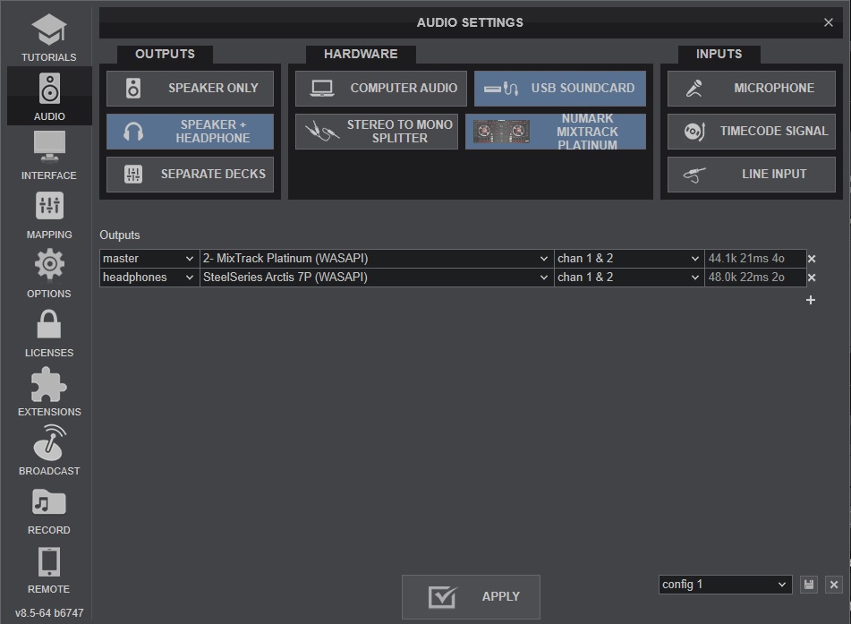

Thanks for the reply. These settings work perfect for me when I'm playing/mixing for myself, but broadcasting it to any other software just seems broken in multiple ways.

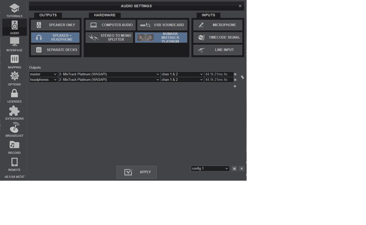

Hey guys I noticed the image I uploaded was incorrect on my settings to what I would perform with. As I had been troubleshooting myself.
Please see the new image and if you have any suggestions based on this please let me know.

The 2nd image shows Headphones on a different sound card, so you shouldnt get the Headphones output when Record/Broadcast.
Perhaps you have the CUE/MIX knob to MIX position ? but still doesnt make sense, unless you use the Heapdhones sound card for OBS input.
Do you hear the Headphones output on your main speakers (connected to the controller's Main Out) ?
You an upload your video to Youtube or any other server and share the link here.

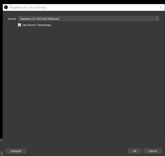

Thank you for your reply. I thought you had got it when you said about OBS input, I thought I may have not set that up correctly but turns out I did (well I think I have)
The image shows OBS capturing the Mixtrack as audio output to the stream.
The linked video was recorded using OBS, so this is what my audience would hear during a live stream to any platform.
