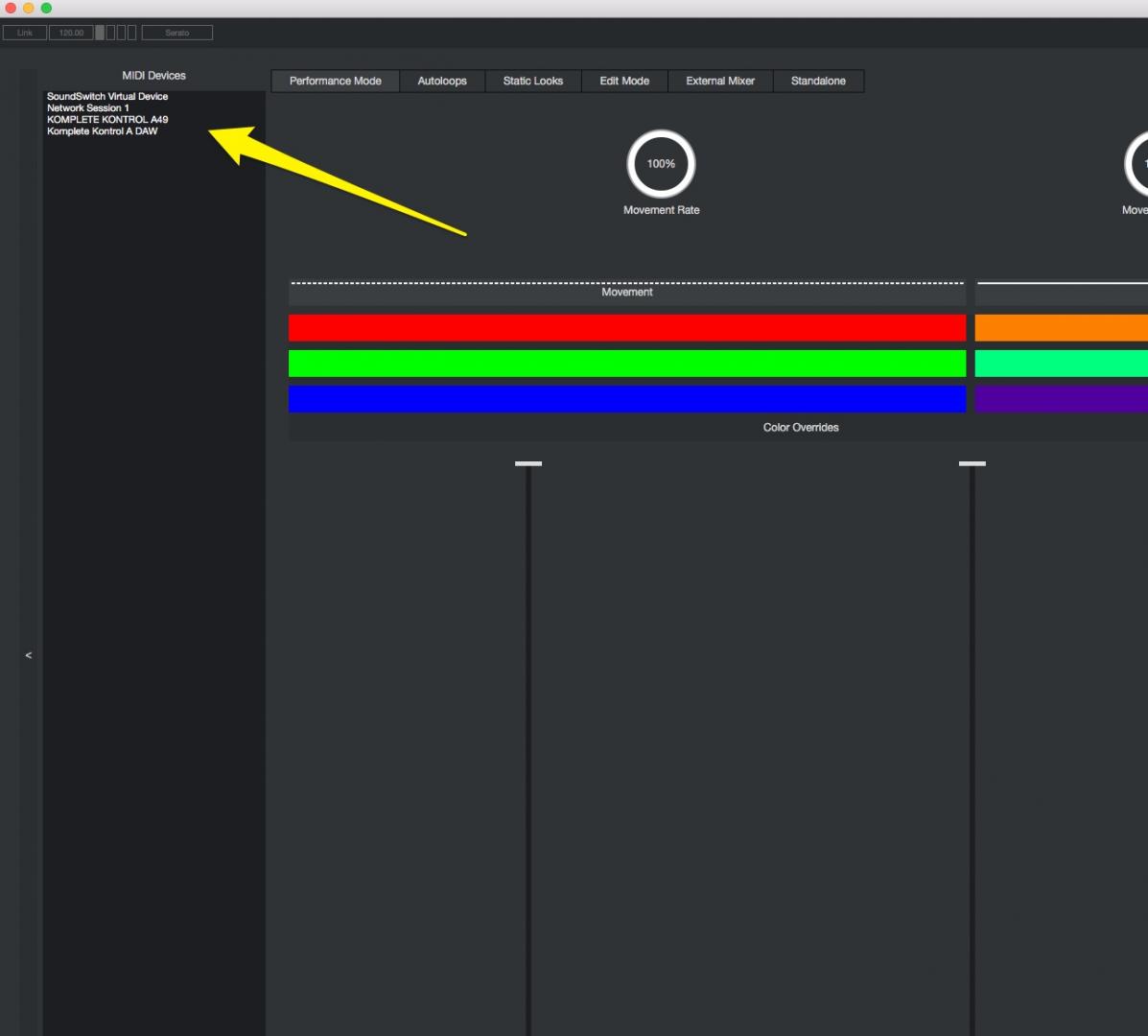

SoundSwitch support knew what was going on and provided a solition that solves the problem:
With the controller connected to your laptop launch SoundSwitch navigate to the Midi page and open the Midi Devices pane. Now right-click on your controller in the Midi Devices menu and select the "Ignore" option. Restart both SoundSwitch and VDJ and this should resolve the issue:
I actually had not noticed the MIDI devices pane in SoundSwitch - it's closed by default and the small arrow on the left side never got me enough attention to try to click on it. I noticed that if I start Virtual DJ first and then SoundSwitch, the DDJ-RZX does not show up on the list because it's taken by Virtual DJ. Starting SoundSwitch first, it shows up and cal be disabled by right clicking on it. Once diasbled, SoundSwitch won't take posession of it and the problem is solved!

Dj Straftanz wrote :
SoundSwitch support knew what was going on and provided a solution to the problem:
