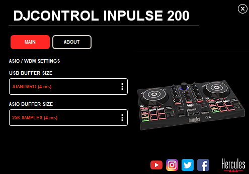

I'm not having any problems with my Hercules DJControl Inpulse 200. I've used it with VDJ for a very long time now and it responds quickly even during double-beats. Here are my settings:
