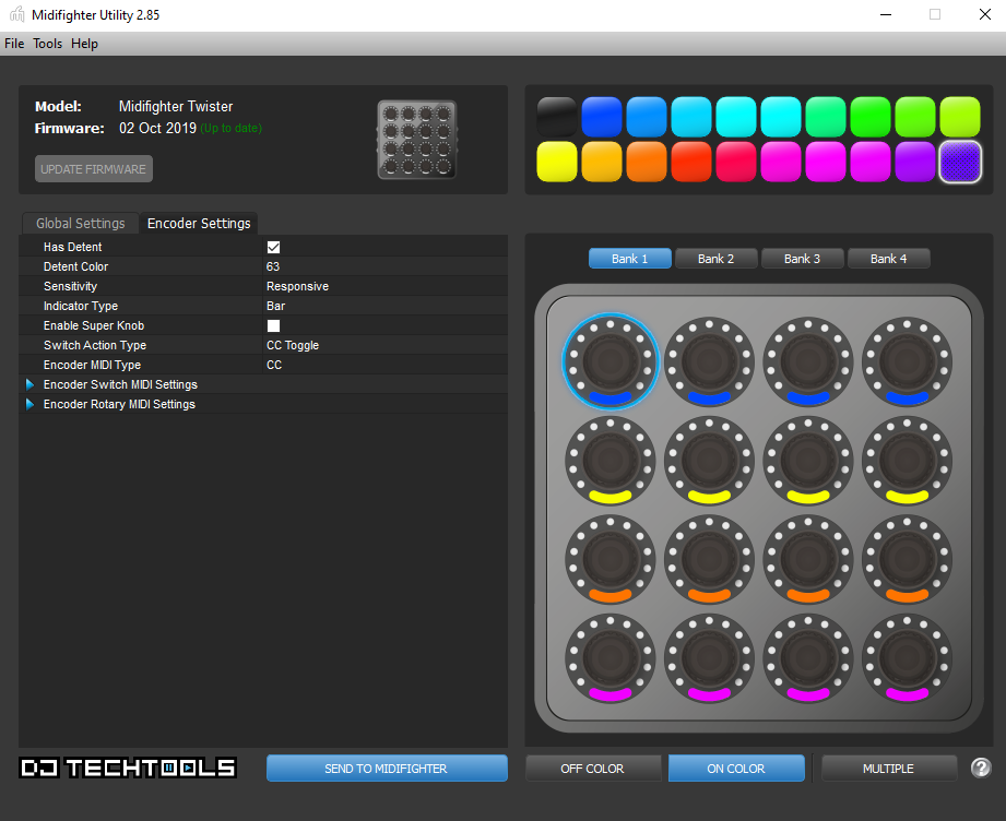

MIDI Fighter Twister Hardware settings:
Bank 1 settings for all Encoders:
Has Dente = Yes
Sensitivity = Responsive
Indicator Type = Bar
Switch Action Type= CC Toggle
For colors, the "Off Color" is black for all encoders. "On Color" is set similar to VDJ color scheme (again, in the MF Utility).
See image for example:
Has Dente = Yes

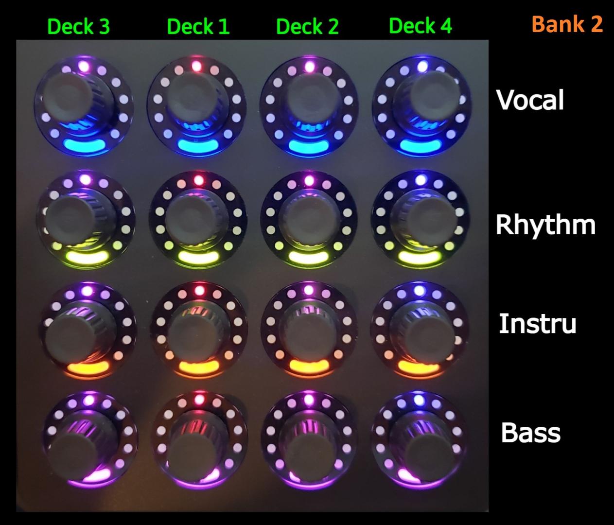

Major update:
Bank 1 is now set for Left/Right decks with all stems.
Bank 2 is now 4 Decks, 4 stems.
Bank 1 config:
Bank 2 Config:
Bank 1 config:
Bank 2 Config:
