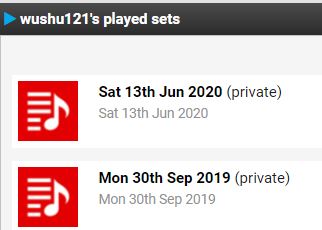

Not sure if this is the same topic, but I know at one time, there a check box you could hit in the settings to keep a running list of songs you played in a set which you could copy/paste into another doc. I have some of these save, but turned off the feature a while back since I didn't know it was doing this and had a ton of them. Not sure how to turn it back on though. It's been a while. I would like to keep track of some mixes and not others, so this would be helpful to have again.
Posted Tue 24 Aug 21 @ 9:02 pm
I found my old post
Can be found in settings -> options -> internet -> sendHistory set to yes/no (select "all settings")
I hope this is still the case as I haven't confirmed it yet. Now if there was a way to delete them in bulk, that would be great. Otherwise I will be there about 25 minutes doing them one at a time.
