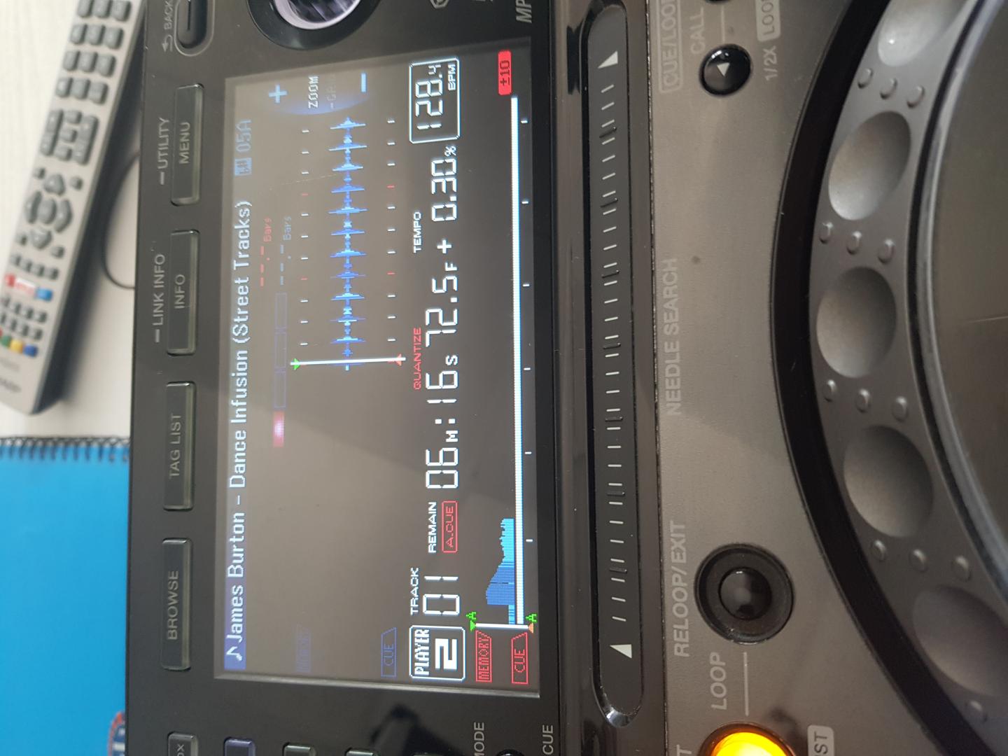

've been recently using CDJ export and taking playlists and songs to a friend to use on his CDJ's, All in all it works well but with quite a few of my songs the waveform is not showing up on the bottom of the screen on his cdj's.. Most songs it all loads up fine but some this doesn't show. All the songs play fine with everything else showing up but some with no bottom waveform on the screen. Does anyone know why this is happening? Thanks. It's otherwise a great feature and means I don't need to get Rekordbox.

Was able to try my usb on a friend's cdjs again today, still no joy. Some tracks loaded up fine, others didn't.. 🤷♂️ tried rekordbox and all loaded up fine. Not handy id much rather use vdj for everything but I cant find a solution for this.

hi . Did you ever find a solution to this. as it happens on my CDJ2000's as well. Its just random tracks. I've compared the data on 2 track .one that loads the waveform and one that wont. and cant see a difference. Ive not been able to resolve it as yet. let me know . Thanks.

Hi there, has this issue been resolved yet? It's happening on my CDJ-2000 Nexus. exact same fault as you guys
