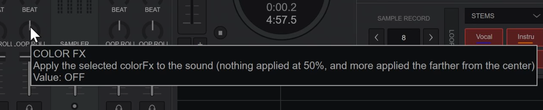

After Adion explained.. I can get effect_colorfx to work from the example in pic:
and can add all 4 color effect knobs to the Right deck and 4 to the Left Deck.
with the assigned effect in " "
Think maybe better to just use Regular FX, though.
still unable to figure out the effect_stems_color or get it to do anything
And would love to be able to apply stems to the ColorFX, if that is possible.
