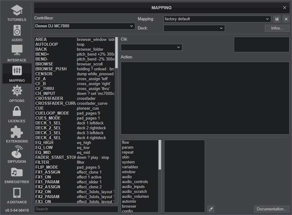

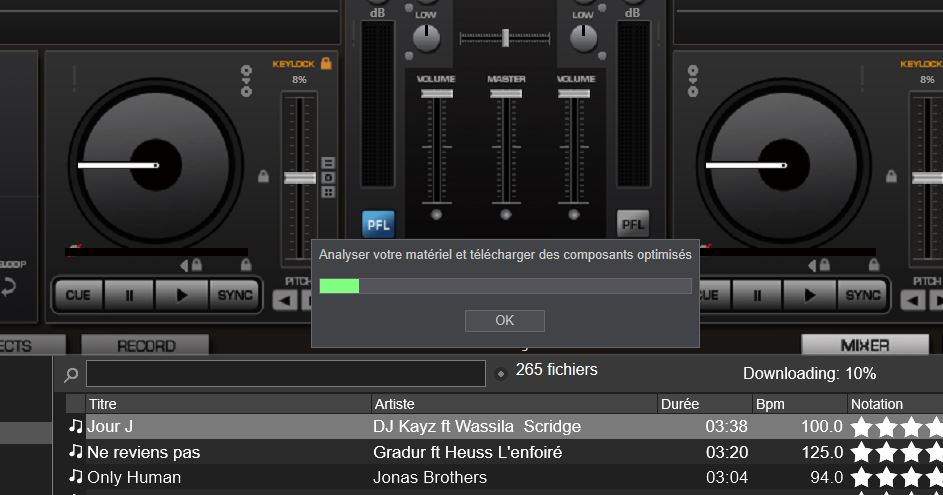

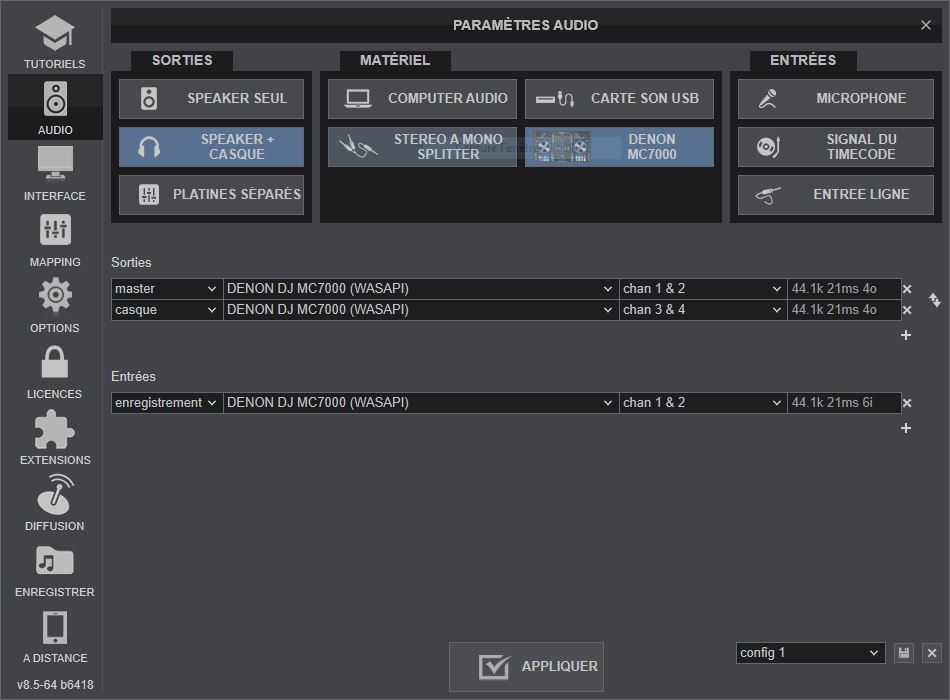

It seems that VDJ only half recognizes the MC7000: It appears in the audio settings, but not in the mapping (there is only the keyboard, and the 3-1-2-4 decks are not indicated) . Last driver is installed. When starting VDJ, there is about 5 minutes of research. See screenshots below.

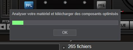

The first part "5 minutes of research" when you start, is an update of the stems engine.
Let that completely update..
As for the MC 7000, hard to tell from the screens, but looks ok at first glance.
Sound card is correctly detected and in use. As for mapper, looks like you might have manually selected that.

You said that you have installed the drivers (Windows ASIO), but in your screenshot i see (WASAPI) in your Audio Setup
When you click on the Denon MC7000 button, doesnt it make an audio setup for you with the ASIO ?
Keep in mind that in many cases if the dedicated audio driver is not used, some functions may not work correctly.
The 2nd screenshot shows that the Denon MC7000 is probably not properly detected as MIDI, thats why you re getting just the keyboard.
