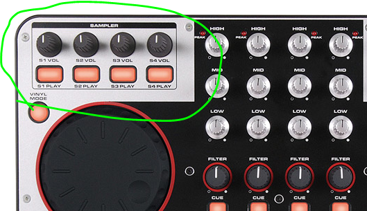

I want to be able to add noise, echo, etc. effects to my mixes but since my controller doesn't have a dedicated effects knob, I'm not sure what I should map it to.
The controller in question: https://imgur.com/a/64abfwO
Thanks in advance.
Thanks in advance.

I would map it at the sampler section top left...
Seems like a "perfect" effect section (unless you use sampler a lot and want to keep them)
Map the knob to : effect_slider 1 1 (next to effect_slider 2 1, then next effect_slider 3 1 etc)
Map the button below the knob to : effect_active 1 (and 2 and 3 and 4)
For example
For example

Hi, thanks for the help. A couple of questions: How do I choose which deck to activate the effect on? How do I set a different effect to each button? And do you have any idea why button 4 isn't lighting up when I press it like the other ones?

Not sure why the last button dont light up. Looks like its mapped to sample 4 play from the image.
So perhaps you didnt have a 4th sample in the current selected sampler bank

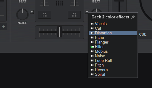

Also, since you have filter knob at all the channels, keep in mind this can be used for Color FX.
Simply change in skin (down arrow near filter knob) to echo, noise etc...
But you might still want a full effect section up in the left corner even if so ;-)
