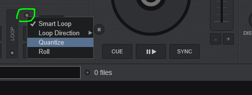

Svenino wrote :
Is it possible to let vdj automaticly adjust the start of a loop on the nearest beatgrid point?
Turn on quantize loop in the loop settings
Posted Sat 17 Apr 21 @ 6:44 pm
and also have quantize value at 1 beat
Posted Sat 17 Apr 21 @ 7:31 pm
Great! Thanks for the quick help.
And just for completeness: With the QUANTIZE option the "loop_move -...ms" isn´t needed any more.
