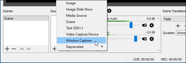

capture the video window with OBS

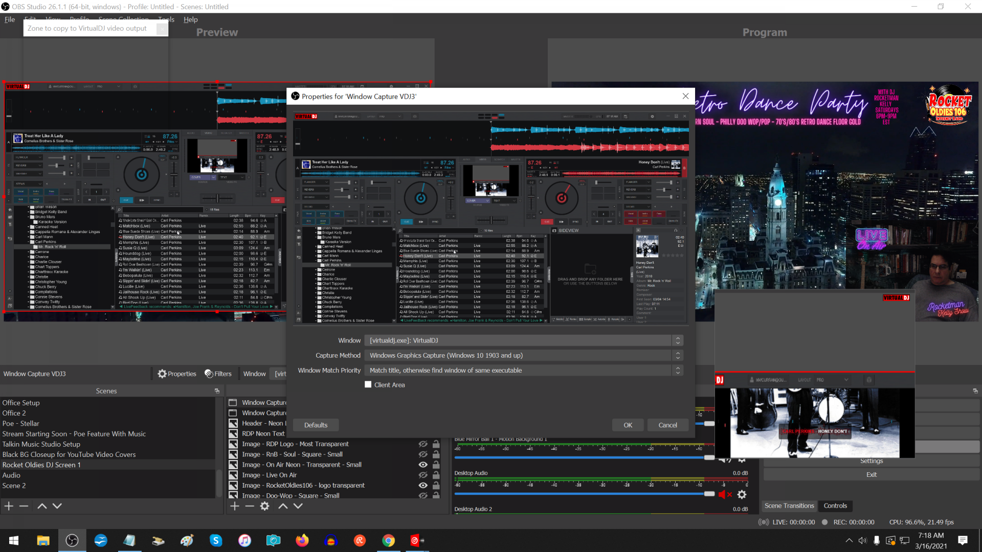

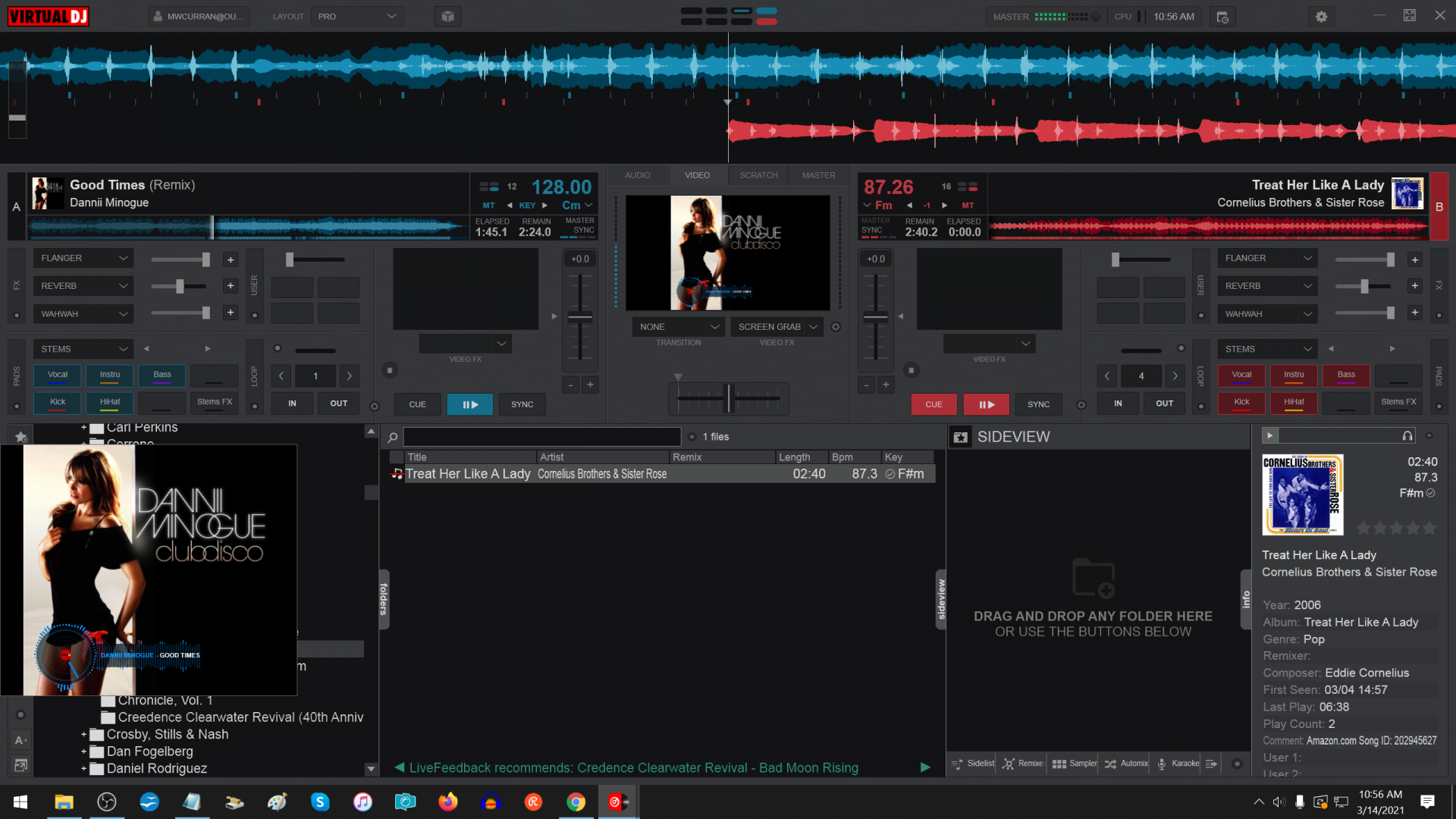

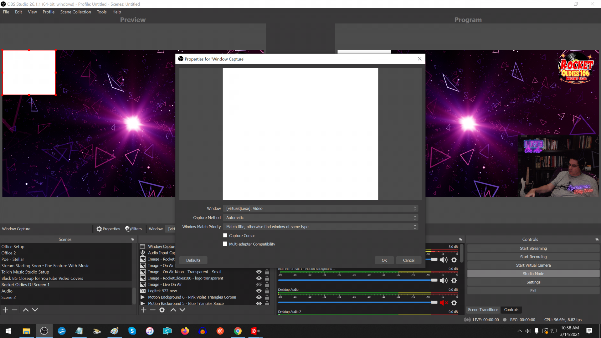

I feel like I am close here but no cigar yet.
So far in VDJ I've got the video output showing with my LP art, track info and the plugin showing spinning platter and song title. In OBS I've selected 'Window Capture' as the scene source and when that opens up, in 'Windows Capture Properties' I've selected 'virtualdj.exe: video' as the source, but I'm still getting a blank window.
Any advice would be appreciated.
Posted Sun 14 Mar 21 @ 6:05 pm

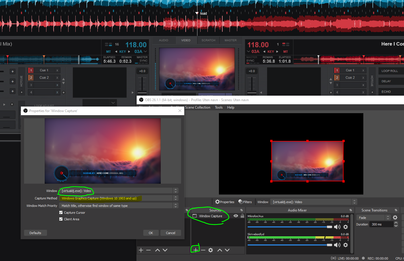

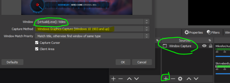

You are close for sure.. hehe
Looking at your post, just try different capture method in the properties, the Windows 10 one probably works great for you ;-)
See image below

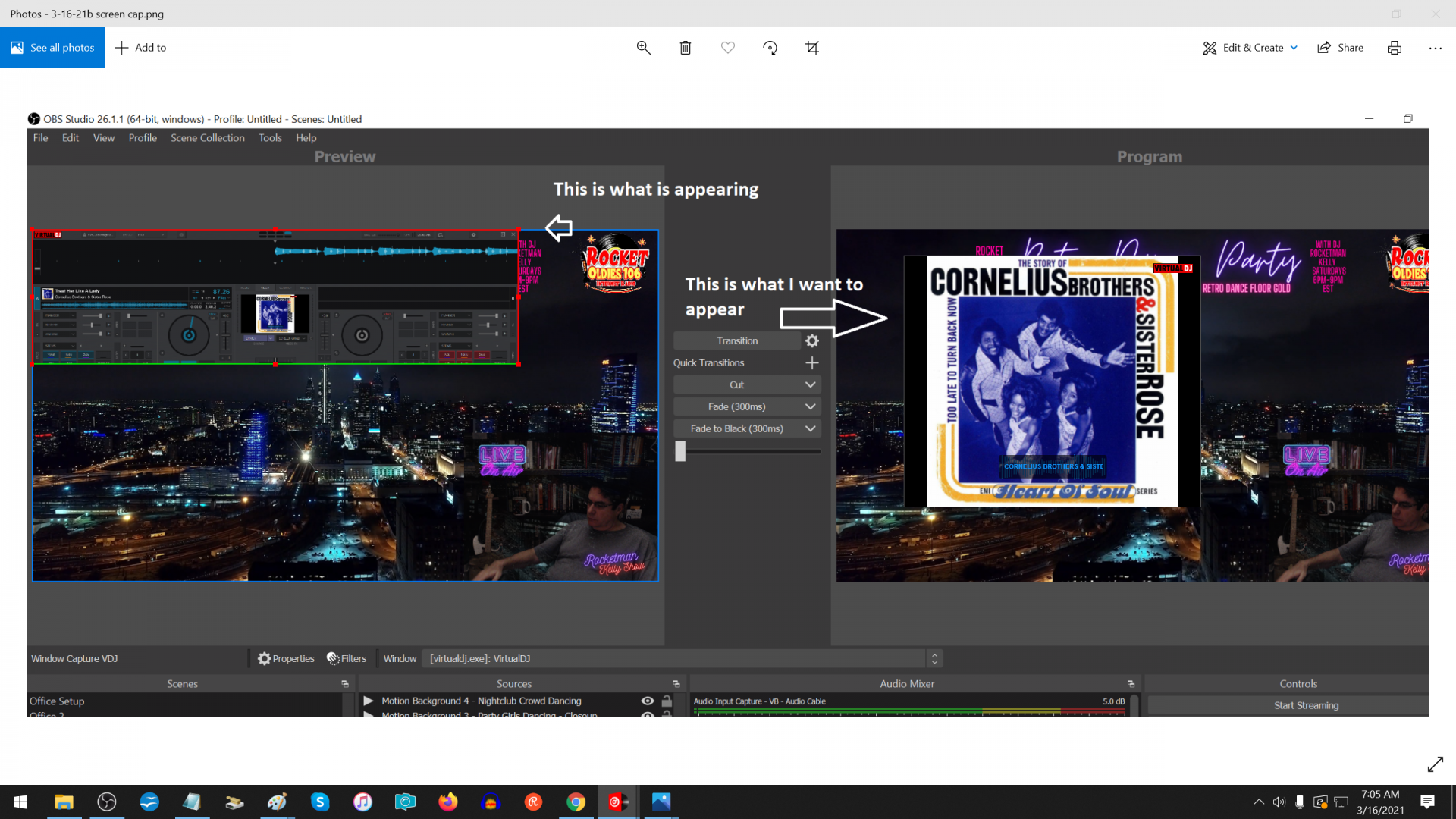

Hi Rune
Okay I tried this and it did work - I got the full VDJ display to show up. Is there a way to get only the VDJ video output window to show up? I don't need the whole screen, just the video window. I tried cropping the full screen down to just the VDJ video window but it's blurry.
You have to select the video window... "VirtualDJ.exe: Video"
And, the video window needs to be open
Posted Tue 16 Mar 21 @ 4:42 pm

Got it! Success! It was really acting funny I think the system resources were maxed out - but now it looks like it's working fine! Thanks Rune!
