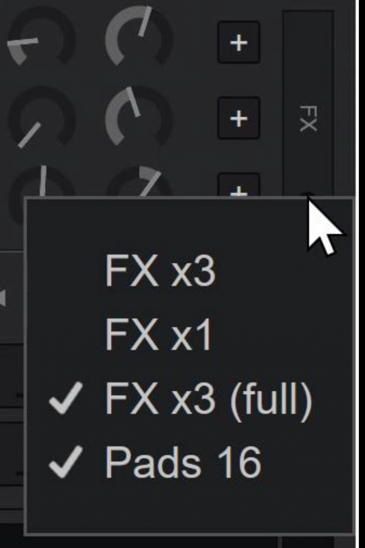

With your help I have created a great ONINIT that set VDJ up when it starts, saving many clicks.
The last change is to set the Fx Panel on the Default Pro skin to "FX x3 (full)".
Currently, "Pads 16" appears after restarting VDJ most of the time.
I have tried to uncheck the "Pads 16" in the selection menu, and it continues to be re-selected and the active Fx Panel when starting VDJ.
How can I either stop "Pads 16" from becoming checked, or have "FX x3 (full)" the active Fx panel when starting? (see pic)
No matter how many times I UN-check "Pads 16", on restart it is checked, and is the active Fx panel.

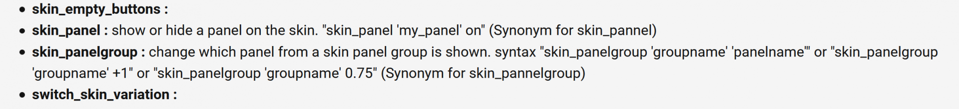

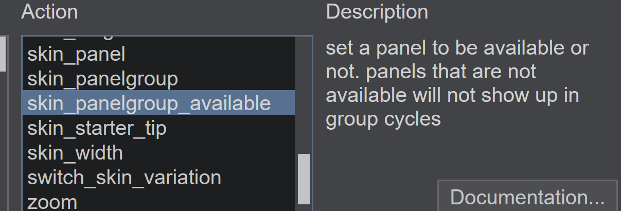

I have found these possible actions:
skin_panel
skin_panelgroup
skin_panelgroup_available
and have been unable to get them to hide or make the "Pads 16" panel unavailable.
Or is this done in the skin.xml file?
skin_panel
skin_panelgroup

skin_panel '@fxknobs_deck1' & skin_panel '@fxknobs_deck2'

trying to understand how to use skin_panelgroup and skin_panelgroup_avail
what I can find is:
which does not include skin_panelgroup_avail, which is only shows
and would be great if I could figure out how to not have the '@pads16' available.
(could remove it from the skin, but may want to use it, at times) (requiring switching skins when wanting to use the Pad 16, which I can be done with a custom button. again big workarounds)
PS I don't understand how to use both, skin_panelgroup and skin_panelgroup_avail
since
the above and many other attempts all do NOT work, to set the Fx panel to "FX x3 (full)"
during those times that "Pads 16" is not appearing, it did not work as expected since the script seems to toggle.
Would be best if there was a way to just specify the panel one wanted to display. I cannot figure out how to do that.
what I can find is:
since
skin_panelgroup 'fx' '@fxknobs_deck1' & skin_panelgroup 'fx' '@fxknobs_deck2'
skin_panelgroup 'fx_[PANELNAME]' '@fxknobs_deck1' & skin_panelgroup 'fx_[PANELNAME]' '@fxknobs_deck2'
