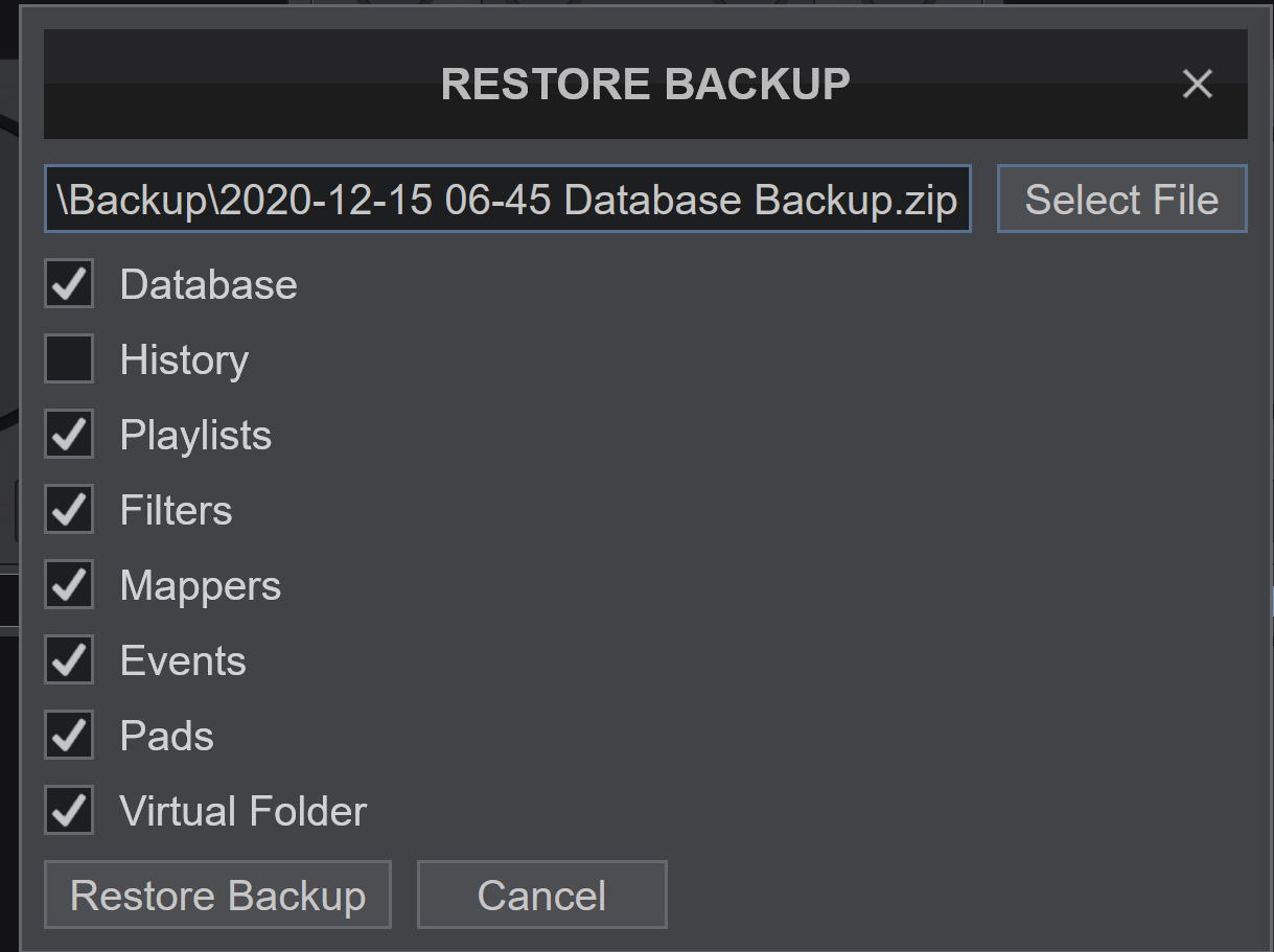

For practice and peace of mind that I could get VDJ back close to the way it was, and learn about the best way to do a clean install, I renamed the VirtualDJ folder in Documents and restarted VDJ.
Then attempted to do a Database restore, that was created moments before, to learn about the restore process.
None of the nearly 100 Virtual Folders and Virtual sub-Folders (the ones with Red Box shaped icons) were restored.
Though the Back up and Restore process window, pictured above, one would have believed that the Virtual Folders are being backed up and Could be restored.
Checking in the zipped Database file, the Folders folder, one finds it contains none of the Virtual Folders that I created so carefully.
(The LocalMusic folder in Documents/VirtualDJ/Folders is where the Virtual Folder Tree, is located and is NOT in the Database Backup, zipped file)
Is this the expected behaviour of the Restore?
Is there a wiki, or procedure for doing a clean install?
