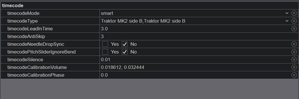

I've set the timecode settings as in the image
& the A6 driver is set to direct thru unticked - usb buffer 4 - process 44000 - sample rate 128
