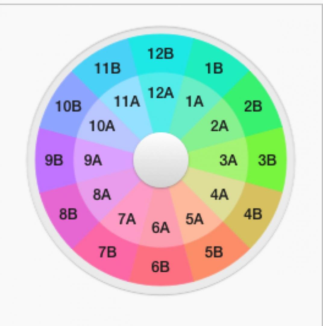

1) How can I show musical keys in a color-coded format within the browser? Switching to harmonic shows color-coding, so this seems possible.

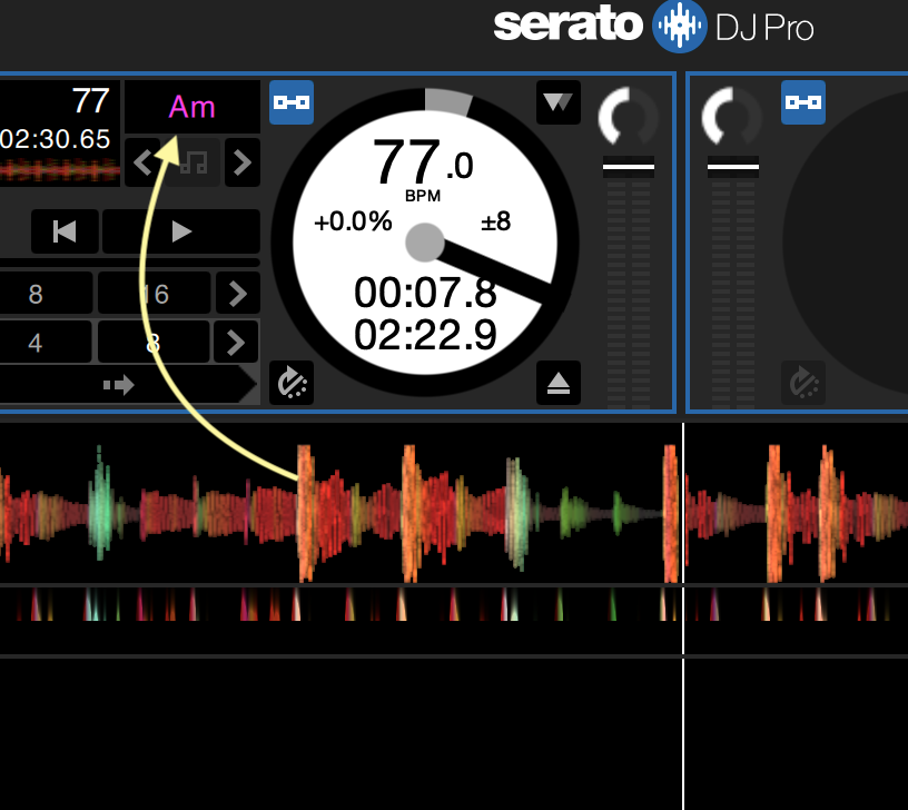

2) Is it possible to show the corresponding color for the key information in the player window? (Example attached)

This seemed pretty obvious, but the Serato picture I attached is to show an example of what I am looking to do in VDJ (ie. color coded key in the track window). As to your other point, the harmonic keys are already color-coded in VDJ browser, so it seems the musical equivalent would be as well? Is there a reason VDJ didn't do this?
Currently its only harmonic key that is. But could perhaps be added an option for having musical key color coded same way.
Reason it is currently, is that the color coding is part of the harmonic key concept. Where numeric and color similar or same matches..
(but could perhaps make sense to show same on musical key, keeping one of the logics above)

Thanks for your reply! Exactly. This seems very easy to implement, as the harmonic key codes were created to represent corresponding musical keys. Is this something that needs to be coded into the application or can it be done on the skin?
