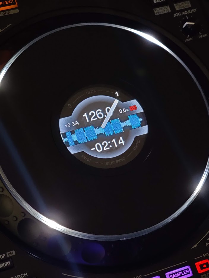

Hi folks, i've come across the "controllerWaveFormZoom" option in the settings, but it appears that it has no effect on the DDJ-1000.
Is this intentional?
Also i've seen pictures of the controller with horitontally symmetric waveforms in the jogwheel displays ('centered' if you will) instead of bottom-aligned as it is by default.
That was presumably with Rekordbox. Is it possible to change this with VDJ as well?
Best Regards, Function =)

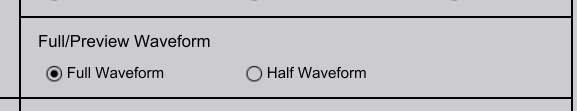

It doesn't do it the same way as Rekordbox does, because VDJ ignores the full/half waveform configuration when sending the waveform to the device. Rekordbox does this. When you set it to use full waveforms for the deck waveform view, it also changes this on the controller.
Here are some pictures:
Posted Sun 28 Mar 21 @ 1:31 pm
There is no configuration (setting) that VirtualDJ ignores.
Anyway, on next build you'll have the ability (via controller options) to toggle between half and full height waveforms.
