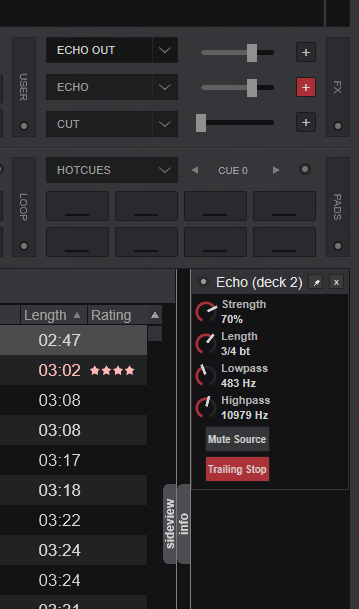

Are those extra two parameters and switch in padfx 'echo' 90% 70% 11% 75% 'Mute Source:on' in the docs? - I was looking at the effect config but only see two?

techtitch wrote :
Are those extra two parameters and switch in padfx 'echo' 90% 70% 11% 75% 'Mute Source:on' in the docs? - I was looking at the effect config but only see two?.
Echo has 4 parameters (as used as percentage values above), and two buttons ("Mute Source", "Trailing Stop")
If you press the [+] button next to the effect, you'll see all the parameters and settings of any effect
Btw, if you leave the 2 buttons on, you can script things much easier, since Mute Source will as it imply mute the deck, so it doesnt matter when you activate pause or if the pause is applied at time of a beat etc :) Keeping it simpler
VirtualDJ action description wrote :
Activate/deactivate named effect with a single key. Effect parameters can be specified as well.
'padfx "echo" 40% 90%' to start/stop the echo effect with first parameter at 40% and second parameter at 90%. When the effect is stopped, the parameters return to their original values.
'padfx "echo" 40% 90% smart_pressed' smart_pressed works as a toggle when pressing the button shortly, or as a temporary while holding the button pressed
'padfx "echo" 40% 90% "TRAIL:on"' after the sliders, it is possible to add strings to disable or enable switch parameters by defining their name, a colon and "on" to enable or "off" to disable
So basically I just used values for all 4 sliders of echo effect (to set low and high pass)
