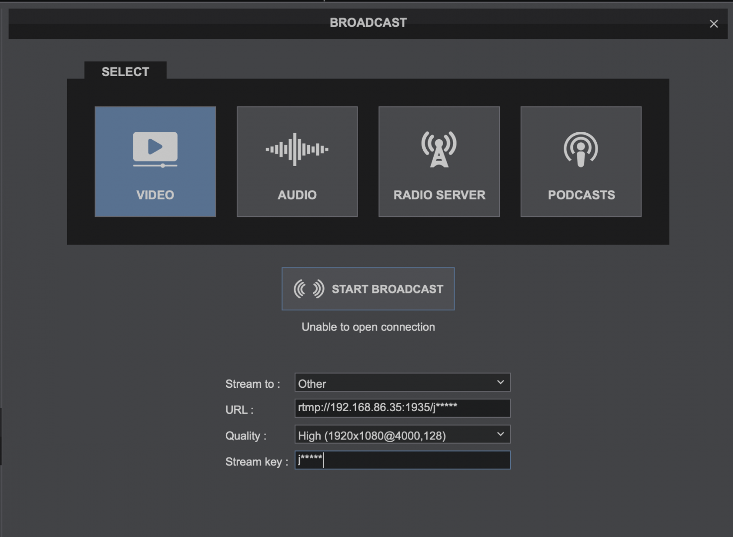

So I've read all the forum messages on RTMP servers and still haven't been able to fix my issue. I'm on a iMAC Pro running Catalina. I tested being able to connect to Facebook and stream live, but when I try to connect to my RTMP server which is sitting on a Windows 10 computer it won't connect. I get a message saying "Unable to open Connection". I tried testing connection to the RTMP server using ManyCam go Live and it connections fine. I just can't seem to figure out why Virtual DJ won't connect. Please help.

Probably shouldnt have stream key at end of url, but maybe the screenshot was just a "dummy" one
