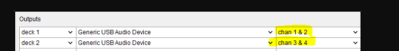

Presonus studio 24c ai and djm 800 mixer. When I go to audio settings and select my outputs and stuff there’s a sign saying i need a license. how do I set up the sound setting to give me a 10 minute trial

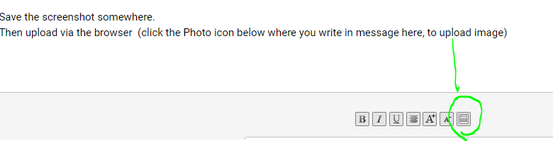

Windows Key + Shift + S
Save the screenshot somewhere.
Then upload via the browser (click the Photo icon below where you write in message here, to upload image)

Posted Sat 22 Aug 20 @ 3:37 pm
Good good ;-)
In your screenshot you can see that there are also warning triangles next to the audio setup entries.
This is because they are non-logic. Both decks in VirtualDJ is set to same channels output (stereo 1/2).
This will not work, since it will be both decks at channels at the external analogue mixer.
You need to either use two sound cards, or set each deck to use mono (chan 1 only for deck 1)
The Presonus is not capable of 2x stereo output. It only has 1 stereo output it looks like
Posted Sat 22 Aug 20 @ 3:39 pm
Oh right forgot to put it at 3 and 4
Posted Sat 22 Aug 20 @ 3:41 pm

Yes, but not sure you have that available at Presonus, but you can check ;-)
Can use another card, or a different card (Presonus is more a "studio" card for guitars and mic recording etc)
Posted Sat 22 Aug 20 @ 3:43 pm
You have both decks feeding the same audio channels. That won't work.
Your Studio 24c is not suitable for DJ use. It only has stereo in and stereo out. For DJ use you need at least two stereo outputs (either one for each deck or master/headphones).
